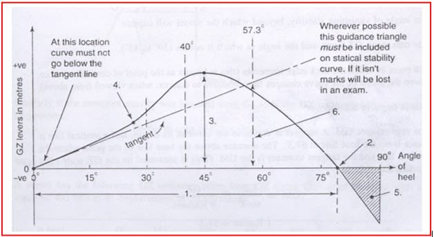

FacEngPE said:
Stability is a matter of keeping the center of buoyancy above the center of gravity in all conditions
That's not actually right. Picture for a moment a stand-up paddleboarder.
If the centre of buoyancy is above the centre of gravity then the system will be stable - that much is true.
If the centre of buoyancy is lower than the centre of gravity then - as long as you can arrange matters so that, when the system is disturbed, the centre of buoyancy moves into the list faster than the centre of gravity does - the system will still be stable. That's how most ships stay upright (and why most of them won't self-right once you do capsize them).
Naval Archs will tell you that the thing that really matters is for the Metacentre to lie higher than than the centre of gravity.
A.
A paddle boarder is a bad example of ship stability, and a very good example of active balance control,
I stand corrected for incorrectly simplifying the ship stability diagram.
Marine insight has a better explanation.
A typical stability curve
In this example, maximum righting moment occurs at a heel of 45 degrees. If the boat heels to the point where righting moment goes negative it's going upside down.
Is a ship rolls point the axis about which it rolls is the metacenter. The distance between the metacenter and the center of gravity determines the righting moment. A greater distance between the two means a more stable ship. Too much stability is not a good thing because it produces a snap roll. Cruise ships and yachts tend to run with lower metacentric heights in order to create a softer rolling action.

Apparently according to the user manual for the yacht, the keel was not required to be down in the event of a storm.
Also, on this particular yacht, when it heels more than 40° or so the vents for the mechanicals will start filling up with water and flooding the boat.
Not sure how the manufacturer calls this "unsinkable"
Check out eSysman's videos
According to Captain Stephen Edwards, who posted his analysis on LinkedIn.
“The Downflooding Angle is much more important though in the scenario we are talking about.”
“This is the angle of heel at which water will start to enter the vessel (usually through engine room or accommodation ventilation ducts)... once this starts the vessels is in serious trouble as stability is quickly reduced or lost due to the flooding.”
“The downflooding angle for Bayesian was around 40-45 degrees... much less than the AVS. So, unless the vent dampers are closed (which with HVAC systems and generator running they would NOT be as they need to be open for that), the vessel will start to flood rapidly if heeled more than the downflooding angle.”
“The vessel Bayesian was sound and seaworthy by design, and to my knowledge well maintained as such. However heeling her to more than around 45 degrees while in normal operational state could result in flooding and subsequent loss if the flooding could not be controlled.”
