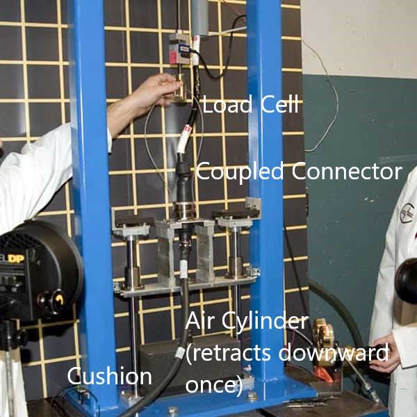

I'm looking for an actuator that can achieve speeds in the range of 30-35 ft/sec (360-420 in/sec) and handle a force in the 100-200 lb range.
I was considering a high pressure air cylinder type actuator but most of the companies I talk to say their cylinders can't go anywhere near this fast.
I found a picture of a setup similar to what I'm trying to build, and it looks like they're using some kind of pneumatic setup. Open to other options too though.
Does anyone have experience with super high speed actuators, or know of a product that might work for these high speeds?

Thanks for the replies.
Budget is not a major concern; I'm looking for the best option in terms of performance (reliability and repeatability, in terms of achieving the same speed each time).
The stroke length would only need to be on the order of 6-12 inches. I added some labels to the picture, so hopefully that helps with some clarification of this application.
It's a one time deal. The cylinder simply needs to retract once at 30-35 ft./sec.
I don't think positional accuracy is an issue. I just need to measure the force required to uncouple a connector, one side of which would be attached to the piston.
The connector would be relatively low mass, I imagine less than 10 lbs. But the force to uncouple the connector could spike momentarily in the 100 lb range.
Once it's uncoupled (which would happen very quickly at 30 ft/sec since it's only an inch or so to uncouple the connector) the force on the cylinder would just be the mass of the connector.
As far as time/distance/acceleration, I'd like it to achieve the speed very quickly, within 1/2" of travel if possible. In the picture below, it looks like they allow 3" or so to decelerate by placing a piece of foam beneath the part being accelerated, so I imagine I'd do something similar.
So far I've been considering a "double purchase rodless air cylinder" that Tolomatic makes. It has an integrated pulley system to double the output speed.
They also suggested a belt drive actuator that's rated for 200"/sec. Could possibly mount a gearbox to the motor to double the speed to the range I need, but I'd be concerned about how it would hold up to being overdriven.
Thanks for the tip on using Nitrogen. We do have dry nitrogen available, just need to check what pressure it's supplied at. I guess alternatively we could use a tank of nitrogen, which we might need to achieve a high enough pressure anyways.
If you want it faster use He. The piping is a pain because of leaks but it will expand faster. Look up the speed of sound in different gases. (H is even better except for the flammability issue)
And electromagnetic actuator would be fastest, but they tend to be very short stroke.

Can the OP describe the actual test? That might easier than randomly looking for actuators
TTFN (ta ta for now)
The test involves measuring the force required to disconnect/unmate a plug from a receptacle. The main requirement of the test is that the separation needs to occur at 30'/sec.
The attached picture shows a lab's setup for performing this test. I'm trying to get as much info as I can out of this photo and replicate a similar setup. They state on their website that they achieve speeds of up to 382 in./sec. within 6 in, so maybe the 1/2" is actually 6"!
The test has been performed in the past by dropping weights from the appropriate height to disconnect the plug at the required speed, but I'd like to build a setup like the one in the photo.

Yes, I've become quite familiar with the Mil standard. That's where the 30'/sec requirement comes from. The 30'/sec disconnect speed is the main requirement of the test.
6 in would reduce the acceleration to 28 g's, a much more practical and plausible acceleration. With something that has 1.5in. diameter, that's like 137 psi.
