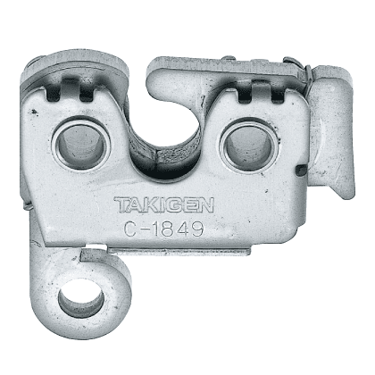

Consider something like:
That's from Takigen: Similar latches available from:
Southco: Austin Hardware:
All three of those suppliers have a wide range of products for consideration, and there are other vendors as well.

Certainly looks like I was on the wrong path with the positive-lock and cam lock pins. The rotary latches look promising, especially as some have vibration damping included.
