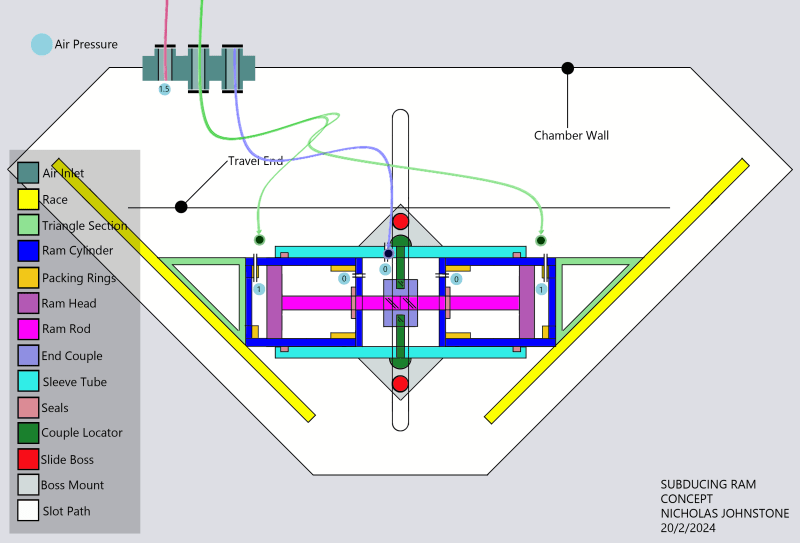

I want to share my thought on what I have called a 'subducing head',
it's a pneumatic engine.
Here's the first drawing==>
The concept is to apply more pressure on one side of a shape within an air compression chamber.
So the red squares are areas of pressure, which don't occur on the other side of the shape,
as the steps mating(wrung) allow the backward pressure face to be culled. Their area in practice ceases to exist.
However this does mean that the feet have to move uphill, and the air pressure will jam them outward,
meaning that inclination has to be overcome.
Would this provide circular movement?

I haven't read everything in detail but... to me the critical flaw is where you say "there is no exhaust". With no exhaust there is no delta-P, no pressure differential. The entire chamber may be pressurized, but it doesn't "know" it is pressurized without some connection to the external environment. Pressure differential causes an unbalanced force, and that unbalanced force causes movement. With no pressure differential, no work can be done. Its one of the three inviolable laws of thermodynamics (exactly which one I'm not sure at the moment). Those laws weren't just made up by some scientist. They were "discovered" as pre-existing laws of physics that apply throughout the universe.
Air pressure acting on the red area in your drawing creates a force that will tend to push your rotor round in the direction you want.
Air pressure acting on the inward-facing surfaces of each piston assembly creates a force that will tend to make the slipper skate down the slope in the opposite direction, with a component resolved in the circumferential direction that's equal and opposite to the force you hope to exploit. This force is harder to picture but it's always going to be there, it's always going to be "equal and opposite" and it's what will always prevent the device from working.
So far as gauges go, you can stick the needles on so they read zero at any pressure that takes your fancy. 0 psia is a less popular choice than you might expect.
One side of this foot may indeed have more area, but this is irrelevant because the pressure on the other side of the foot is the same pressure, so there is no differential pressure.
No differential pressure, no force and no movement.

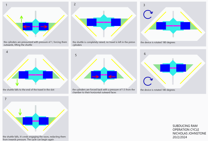

heya peeps,
please assay this one for a concept:-
the rams push outward forcing the main body up the races
when it has climbed as high as the travel allows,
we spin it upside down,
that will release it from the rails.
then the pressure in the chamber,
which is higher than the rams,
will push it closed again.
Then turn it right side up, and the head fall back to start orientation.
Now the redacted face allows it to start climbing again.
How do you like them apples?

pressure from the compressor is applied all the time,
but there is no exhaust/relief
To start a cycle the rams push open,
when they have travelled fully upwards,
the chamber is up-ended.
That allows the pressure in the chamber to close the rams,
as the rams have fallen away from the races
Then the chamber if flipped again,
and the shuttle falls back into a pushing state,
re-starting at the beginning of the cycle again and pushing upwards off the V races

The sliding face of your triangle piece is exposed to chamber pressure throughout - both when it is in contact with the race and also when it is not. "Redaction" is not a real phenomenon (if it were, we'd have to find a way of making things without plain bearings, because they wouldn't work any more).
If chamber pressure is greater than ram pressure, the rams will retract and then just stay put.
Here's the 'order of operations' ==> What this is doing is possibly operating a potentially high power ram set,
using gravity as the switch for now

Energy goes in, nothing useful comes out, making for zero efficiency, which is perfect. A similar result happens in sand timers.
If light-blue represents pressure and white represents absence (or less pressure) then the transition between frame 1 and frame 2 involves the pressurised fluid performing work between the cylinder block and the yellow things. Step 3 represents no work being done. Step 4 represents no longer any mechanical contact between the pistons and the yellow things, which presumably means the pistons have reached a mechanical travel limit imposed by something else not indicated in the illustrations which is fine. Step 4 does not happen because the yellow things are no longer in contact and cannot transmit any force; pushing the pistons in would requires mechanical work being put back in that precisely offsets that which was done between frame 1 and frame 2. Anything beyond that point is irrelevant because step 4 could not happen as shown.

This closed system has frictional losses in the piston/ram seals and no outside connection to do work, so outside energy is expended to flip the system 180 degrees on some type of cycle. Energy that is not provided by the inside system. As 3DDave has noted, your mechanism is analogous to a sand timer. I am missing the goal of the experiment.
