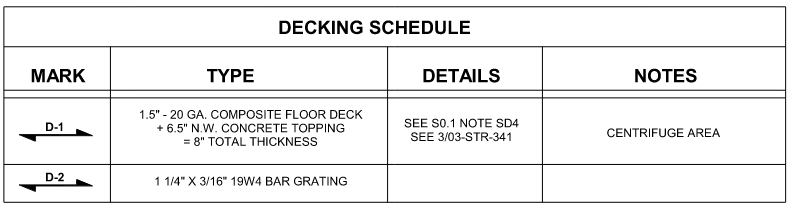

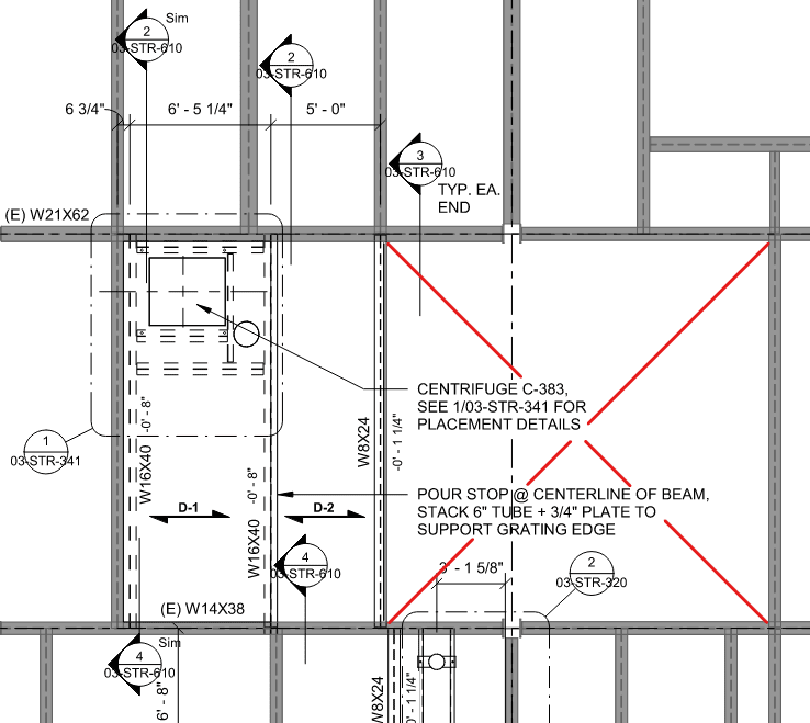

I did one of these back in 2019, inside an existing facility. I anchored directly to the steel, but also through the concrete - essentially the concrete was just mass to help with the vibrations. I didn't try to make the concrete composite to the beams, and I didn't try to pick up the extra stiffness due to the concrete. See the pics below for final install design. I did have the chance to be at the site while they were using the centrifuge - you could tell it was running (there was some vibration in the slab), but it didn't feel like anything crazy was happening. Just a "yep, the machine is on".
The centrifuge weighed 5,250#, but I can't seem to find the bowl speed as I look back. In my RISA model, I'm getting a natural frequency of 6.7Hz, so I'm going to guess that the bowl is spinning faster than that.
I ended up adding enough studs to get composite action between the slab and the beams. The actual stiffnesses using the code provisions for composite beams ended up working out almost the same as if the slab was modelled as a plate element in the model. Some literature suggests the vibrations won't be sufficient to break friction, but that is only considering small vibrations, and I'm sure during run down my centrifuges would break friction. I recommend some sensitivity testing to vary the stiffness of the concrete deck, say +/-50%. It may seem like a lot, but changes in stiffness don't generally have a huge effect. As wineland did, I bolted through concrete straight to steel - the load the anchors actually see is quite low though. In general between the mounting plate and the centrifuge you have isolators with limited or no uplift capacity anyway.
FWIW I had three centrifuges, approx 20T each, running at 25Hz+
