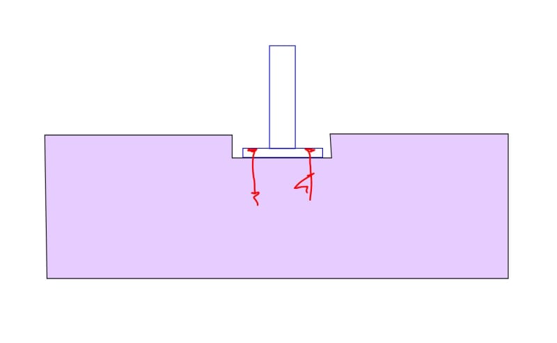

Will you be able to screw a stanchion base plate to the top of the stringer? Or are you intending to actually embed the post in an epoxy filled hole or something? I might have some issues with the latter approach.
I don't feel that there's any way to sidestep cantilever behavior here. The load sharing may reduce the base moments that you have to deal with but it wont eliminate them.

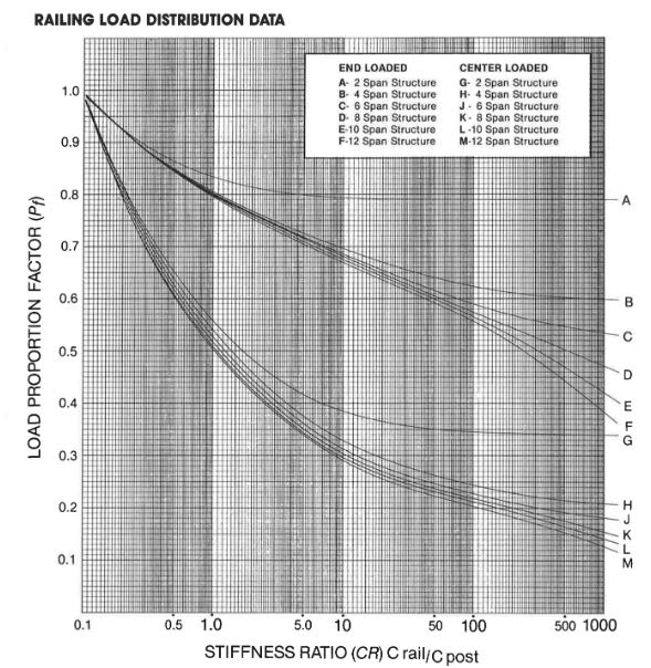

I know of a good document that speaks to the load sharing if you're interested.
Only if the connection can be hidden after finishes are added. I agree, the latter doesn't feel right. Current strategy is to weld the post to a vertical plate and then bolt that to the side of the stringer.

I'd need to see the final proposal before passing judgment but I worry that the embedded connection would generate local cross grain bending and tension perpendicular to grain stress that might not perform well over time.
Love it. Do that if you can.

I'm thinking of NAAMM's metal stair manual. Who doesn't like a sexalicious monograph? Your FEM would be just as valid, if not more, of course. This might just serve as a useful check.
