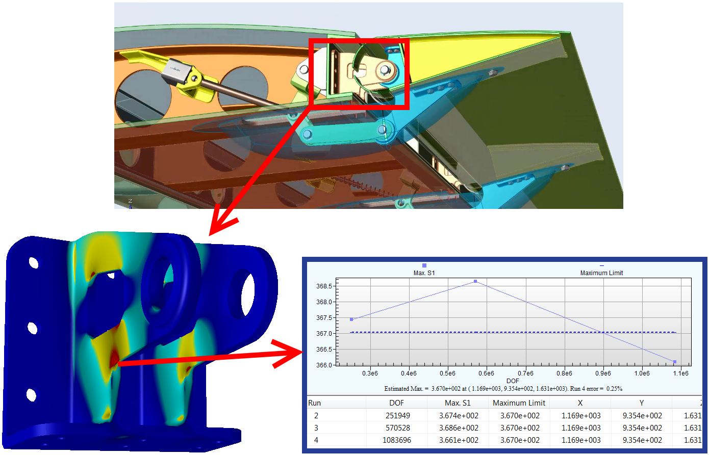

The situation I have is a hinge on a cantilevered structure that shows no visible damage. I suppose the concern would be that there could be micro fractures developing in the material that could grow over time? From what I’ve read ultrasonic testing should be able to check for this
There are 3 high strength hinges that support the whole structure

I'm trying to figure out what type of damaged I should be worried about and how I should check for it. There's concern that the material might be damaged and I need to suggest what should be done to ensure it is safe, whether that be give an explanation why there is no concern, or suggest a method of NDT.
