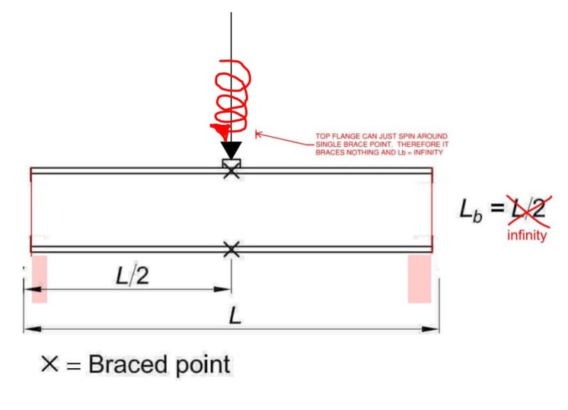

Alright, so my questions:
[ol 1]
[li]In my first snippet AISC states this limit states only applies to beams where relative lateral movement between flanges is not restrained. However, Figure C-J10.2 (or J10.3 depending on edition) defines the unbraced lengths used in the web sidesway buckling equations. The last figure shows the top and bottom flange braced at the location of the concentrated load and defines the unbraced flange length as L/2. Shouldn't the limit state not apply?[/li]
[li]AISC states for flanges "restrained against rotation", do they mean - the local compression flange is restrained against rotation or the entire section is restrained against rotation? Or do they mean that the compression flange is restrained against lateral translation? In figure CJ10.1 they show the compression flange as being braced against lateral translation. Also in the commentary they state "(such as when connected to a slab)".[/li]
[li]Would this apply to the end of a uniformly loaded beam? I want to say no, because it states the "loaded compression flange". In the case of the end of a beam, you would have a "loaded tension flange".[/li]

I believe that they both require rotation restraint at the ends. For this, for LTB, and probably for a bunch of other issues I've failed to consider.
And they've got nearly identical rotational stiffness at that point. Doesn't add up.
Look at the derivations of the provisions in the papers we've both been reading and you'll clearly see that the derivation calculates brace stiffness assuming a lateral demand on the unloaded flange at the center of the span, where it's most flexible. Sure, Lb is the same. Lb just isn't the whole story. The exercise is really quite similar to what you've been doing DIY with your FEM.
You can't pick and choose where/when you will follow the code. If you want to go with strict interpretation (that you've been using) it says point blank: "largest laterally unbraced length along either flange at the point of load". That could never be 8.5' or less in Scenario #1. (With or without point load bracing.)

Woah.. gotta back this one up bit. What I meant to say above was really:
1) Neither of your scenarios has a stability demand at the very ends of the beams because the reaction is delivered directly to the webs rather than the flanges.
2) Both of your scenarios require rotational restraint at the very ends to prevent LTB but do not require it for web sideways buckling.
3) The requirement for for rotational restraint at the very ends of the beams in both of your scenarios is satisfied by clip angles etc and stiffeners are not needed.
All that adds up for me just fine.

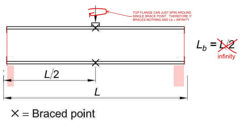

Not for the rotational restraint for the end bearing situation (for example). Without a stiffener (and proper bracing), you are down to web distortion. It's the same thing as what is happening at the center of the beam (except with half the load)....only inverted.
I'm not advocating not following the code. I'm simply adapting this particular code provision with some measure of creatively and skill. The code was never meant to preclude the exercise of engineering judgment by qualified professionals.
I haven't suggested messing with the unbraced length. Rather, I would calculate my faux spring brace stiffness using the usual Lb and the load required to induce a unit lateral displacement at the actual load point rather than doing the same thing at mid-span as J10.4 does. This would improve accuracy and reduce redundant conservatism.
I'd be careful though.....Figure C-J10.2 shows in some cases the unbraced length being equal to the full length in some situations. (Including when the compression flange only is braced laterally at mid-span.)
Agreed. It's actually much worse even with half the load owing to:
1) Less web to work with to stabilize the top flange AND;
2) An unloaded flange that's pretty much worthless as a brace since it's a cantilever with it's fixed end who know's where in the interior of the beam.
Neither of the J10.4 checks would cover this if one were determined to do it for some reason. You'd probably have to rework the equations such that they only depended on the web for bracing.

So in summary, the difference between Kootk's stance and WARose's is as follows:
If I have a beam that is braced at the ends and a point load is applied at some point along the span, in order to eliminate Web Sidesway Buckling (WSB), I can brace the top of the beam against lateral translation and add stiffeners. The stiffeners would prevent the bottom flange from moving relative to the top flange.
Kootk says correct
WARose says it is still possible
I would also ask - Does the section also need to be braced against rotation at this location?
Is my statement above correct?
In the context of a normal human interaction (bar/lunch/cubicle) I would say that your summary is in accordance with my beliefs. Here, in this thread however, greater linguistic precision is required in order to keep me from getting forever harangued over the details. Here's a tweaked version of your statement that I consider to be logically flawless.
RFreund said:
If I have a beam that is braced against relative flange displacement at the ends and a point load is applied to the top flange at some point along the span, in order to eliminate Web Sidesway Buckling (WSB), I can one option available to me is to brace the top of the beam against both rotation and lateral translation at the point of load application and to add one pair of properly detailed stiffeners at that same location. The stiffeners would prevent the bottom flange from moving relative to the top flange.
Yes. However, if you're going down the stiffener path then you'll have provided rotational restraint to the loaded flange already and this will be a moot point as that, in combination with the stiffeners, will effectively brace the beam against rotation at the location of the applied load.
Stability demand really has rather a lot in common with death and taxes:
1) Paying the bill is unavoidable.
2) The bill need only be paid once. Once paid, there's no need to keep paying it further down the line.
3) Once the bill comes due, it's best to pay it as soon as possible rather than to let things drag on. This, in the temporal sense for death and taxes and in the spatial sense for stability.

I believe your assessment of Lb to be in error. And, if that's the case, it's quite a fundamental misunderstanding of the J10.4 provisions as they would be applied to the case of a bearing condition permitting relative lateral displacement of the flanges. This, because of one of my previous observations, repeated below. Please give that statement additional consideration in conjunction with the sketch that I've provided below. Everything pertains to WSB at the unrestrained bearings rather than at the applied load.
In your sketch you say: "Top Flange can just spin around single brace point. Therefore it braces nothing...."
That isn't the situation I am talking about. Relative to that sketch, I am talking about where the beam is laterally restrained (top and bottom) at (say) the mid-point......and you have a bearing/seat connection at the end (with no restraint). That's where I think sidesway still applies (with lb=l*0.5). And it is a fairly common situation.

[blue] (Kootk)[/blue]
You're going to have to baby step me through what you mean here I'm afraid. As far as I can tell, my sketch is exactly the situation that you've described above:
Quote (WARose)
Check. Those are the two "x" marks in the sketch.
In the sketch above (i.e. in your post of 8 Apr 18 21:26) you say: "Top Flange can just spin around single brace point. Therefore it braces nothing...."
I'm not talking a single brace point.....I am talking the two "x"'s shown. I'm not sure which situation you are considering here......but in the scenario I am considering, it is impossible for the top flange to "spin around" mid-span because the top and bottom flange are laterally restrained.

Hmmm... perhaps I have not adequately conveyed to you which axis it is about which the spin would occur. How about now? A brace top and bottom would not restrain this type of movement in the top flange.
I believe that you are talking about a single brace on the unloaded flange. For the type of motion that I'm considering, the brace to the bottom flange would be irrelevant. What you'd need is two top flange braces to provide restraint.

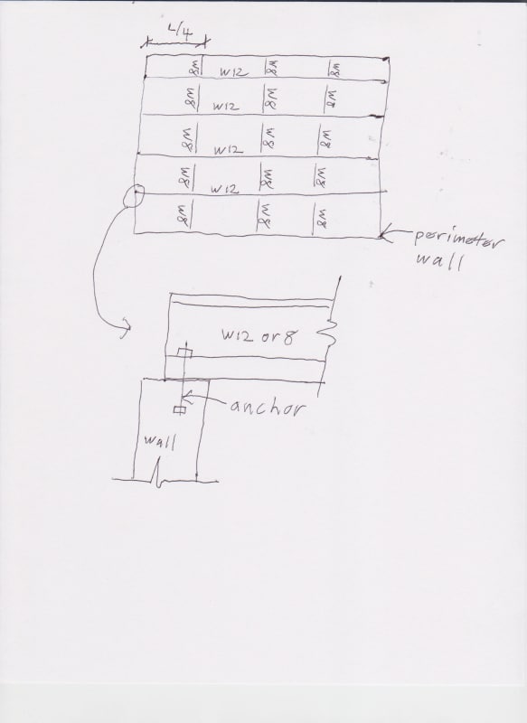

For the lateral brace (top and bottom) I am envisioning a full depth (or close to it) beam framing in.....and either the rotational strength of the connection at that point....or multiple braces taking care of that.
More specifically, I am thinking of a scenario like this:
I've seen that layout about a thousand times at chem/treatment plants (i.e. grating over pits/tanks, occasionally picking up a post load).....and the bearing of the W12 on that wall would seem to me to be susceptible to sidesway (if L/4 got big enough).

Ok....the beam rotating on a axis at mid-span, in and out of the page?
Close. Not the beam as a whole, just the unloaded (top) flange. The very flange that one hopes will be providing lateral restraint to a web prone to WSB.
WARose said:
Well that isn't possible either based on the scenario I am considering.
In your scenario, as sketched, your top flange has more than one lateral brace which conflicts with your previous statements about it matching the commentary figure, right? If we've been discussing the commentary figure all this time and what you really meant was this six point bracing scheme with the span equal to four infill framing bays, then surely you can understand why I've been a little slow on the uptake.
While your scenario is better than a single point top flange brace, it's still going to be ineffective as far as the web trying to gain lateral restraint from the flange. That, per my original comment below. Your Lb would be difficult to calculate and would take on some value greater than L/2 (propped cantilever-ish).
I would hope that the connection detail that you sketched is not as common as you've implied. Without stiffeners, it's a WSB nightmare for the reasons just discussed. All you've got stabilizing the unloaded flange from WSB is half a web and no flange. It couldn't even be assessed via the J10.4 equations without modifying those equations substantially, and substantially for the worse.
I could have cut it down to just two and said assume rotational restraint at that point (from the connection).....but rather than starting off on another point.....I felt this cuts to the chase a bit quicker.
[blue](Kootk)[/blue]
Possibly. But I think you could arrive at a number.
I've seen it a bunch of times. (Especially in older structures.) Looking at the older calcs.....they'd run with Lb=L/4 (for the LTB check).....and no check on sidesway. (Scary eh? Of course, I don't think sidesway was even part of the code until the 80's.)
Like you said: it presents the same difficulties in sidesway that it does it LTB. I use to work with a guy who compensated by using Lb*2 for LTB, etc. It's been a while since I have had to face it so I cannot remember what I have done. (I'm usually ultra-conservative.)
