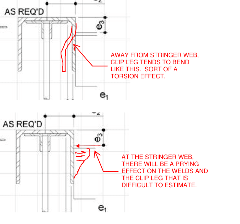

I don't use it for real loads, but you can design for it, if you have to. If you clip the leg from an L8x8x0.5, then you can pick up some 'heavier loads', but you can design for it. No rocket science.
Torsion in an angle is about as close as we get to "rocket science" in steel member design. Design Guide 09??
Torsion is complicated, but you don't have a lot of it here! I think you are looking for problems that aren't there.

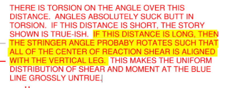

Unless we're talking about different things, the reaction on the clip angle would be in the middle, and not at the end as you have shown.
How about a sketch? Heck, take mine just add a dot and an arrow to it or something.
dik said:
Any torsion generated is negligible, IMHO.
And in my opinion, it's the dominant design issue for the alternate scheme proposed by OP's fabricator. Moreover, since you're obviously not checking the torsion, it would seem that your opinion in this is based on qualitative judgement at best.

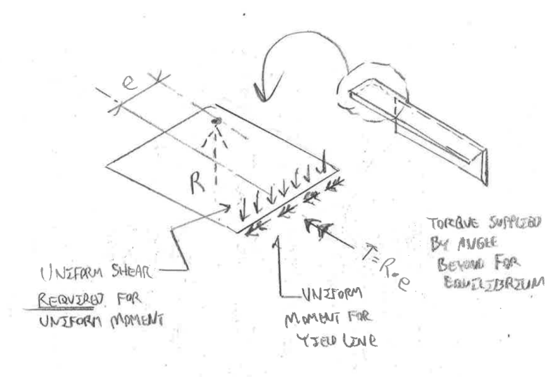

I prepared the sketch below to further explain my belief that there is no way to do these two things simultaneously:
1) Utilize a weak axis, flexural yield line that is the full width of the horizontal angle leg and;
2) Reduce or eliminate the torsion in the stringer angle.
Fundamentally, I believe that this is because, once a full width uniform flexural yield line is chosen by the designer, a commensurate full width shear field is necessary on that line in order to satisfy equilibrium. So the only path to reduced angle torsion, then, is to assume a flexural yield line width shorter than the full angle width.

The intent of my summons was not to get your input on our little deck angle discussion although your comments are, of course, welcome. I believe that I'm on to something much deeper than that which, I hope, might answer a long standing question that I have regarding concrete flat plate design.
If you consider the sketch below in the context of this thread, you'll agree that we have two, competing wishes for this:
1) We would like to be able to use the full width of the flange in flexure, ala yield line voodoo.
2) We would like the center of shear in the cross section to stay close to the shear center of the cross section in order to limit torsion on the member.
I hypothesize that those two wishes are incompatible. I believe that, once you lay claim to the full flange width in bending, that locks you into spreading the shear out uniformly as well. And I believe that I can prove this, somewhat, via hand sketched physical reasoning which is, as you, my preference with most things.

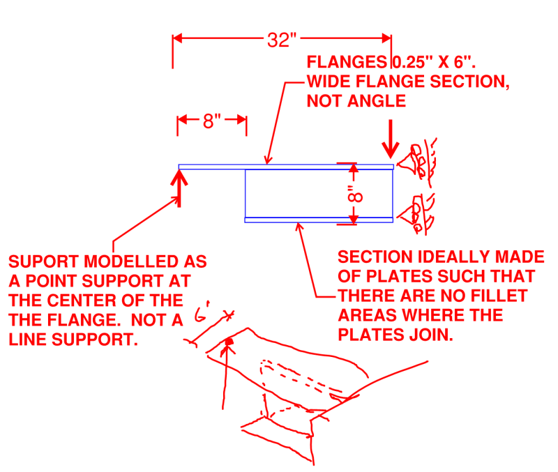

Ideally, what I would also like to do is model the setup in a way that would confirm or refute my hypothesis. However, the model would have to incorporate flexural plastification along the bend line and the associated redistribution of internal forces. Is this something that you would have the ability to do if you had a mind to take it on?
Should you be feeling super keen, please don't run off and model the angle. I would want to test a similar, easier, more strategic setup.
I can crank the handle and run a model of your choosing. I can model the whole setup here without too much difficulty. But I cannot model "flexural plastification", I did have a quick check of Nastran InCAD which I use, but no plastic modelling that I can see. Scratch that I can deal with plastic deformation... Give me the idealised model you want and I'll run it. Honestly I think modelling the full angle setup is workable and not difficult.

I agree they are soley incompatible for the reasons you stated.

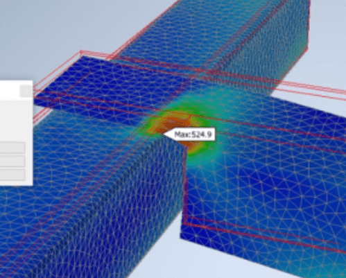

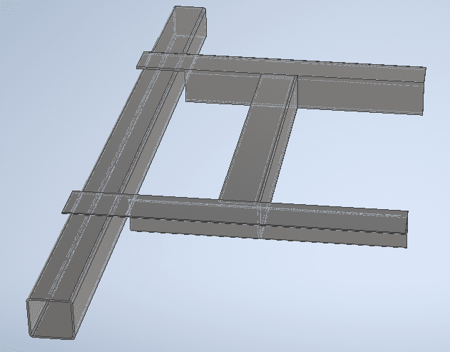

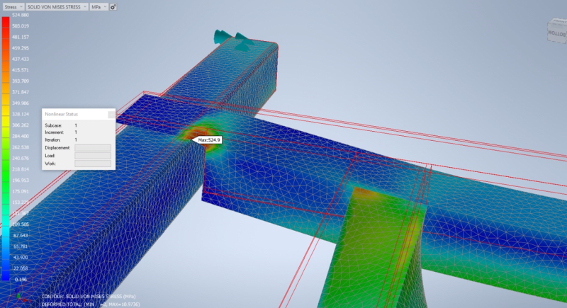

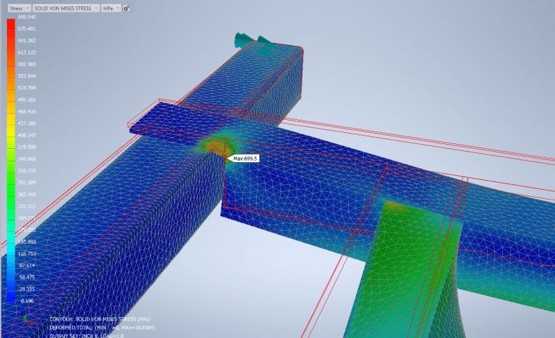

I modelled it up.
The model (half model using symmetry)
Without plastic deformation:
With plastic deformation:
Nothing amazing or surprising to see here IMO. But if you want me to do more just ask.

Kidding, obviously your at liberty to model whatever you want to model. That said, I have a very different model in mind that will be designed to strategically tease out the things that may be "amazing or surprising". That stuff tends to get lost in the noise of unnecessarily complex modelling exercises.
As far as what you've modelled so far goes:
1) If the plasticity has been modelled as we discussed, there would pretty much have to be an interesting result in there somewhere. Either the shear at the bend line is uniform or it is not. Either way, I for one would find the result interesting.
2) I feel that the interesting things to see from a reporting perspective will not be the Von Mises stresses but, rather, the principle bending and shear stresses at the plastified bend lines. If the plastification has been modelled as we wish, there really shouldn't be a flexural stress hot spot as shown below.
Again, though, I would recommend holding off for the more strategic modelling setup.
This is what I want to model. I mean to make this exercise it's own thread but, since your patience wanes, I figured it best to get this in front of you sooner than later.
Also, if there is some way to make the yield line bend line a boundary condition such that the plate elements butt up cleanly and squarely to it, that would be helpful.
