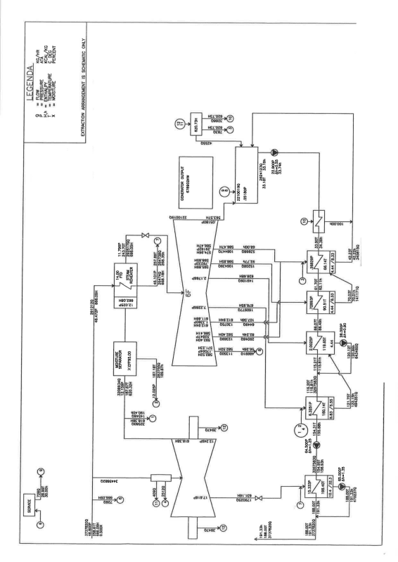

I have a Nucleare power plant operating with a regenerative cycle, that has also spillages in the High Pressure turbine and in the Low pressure turbine(they are 3 LP working in parallel).
Hp and the 3 LP are biflux.
Regarding the 3 LP, I have 6 spillage each, and the problem is that the first one is done between the 1st and 2nd diaphragm on the left side, the second is between the 2nd and 3rd diaphragm on the right side, and the last four are thank god simmetric (2 on the right side and 2 on the left side).
Now, i know the pressure at the inlet of the 3 LP and the overall Steam flow that goes to the 3 LP(i don't know how much flow goes in each LP turbine), I know the Area of the exit of each spillage, and i know at which pressure the flow exit through each spillage. The remaining steam exits the LP going into a condenser (at 0.05 bar), and i know the overrall remaining steam flow and is pressure.
Now the happy part! The 3 LP turbines do not have the same Area of spillage due to calibration, and some are very much bigger.
How can i calculate the steam flow though the spillage?

here the link to my dropbox for a bettere resolution of the image
as you can see, I attached the example of heat balance of the power plant. The problem is that it groups all the 3 LP turbines in 1, and I only have the sum
of the steam flowing from the 1st bleed( don't know why they didn't supply the bleed flow from each LP turbine).
But, since I have the pressure of all the heat exchanger with the Feed water, the bleed Area,and the total steam flow and the overall bleed flow from each bleed, I should be able to calculate the bleed flow of each bleed of each LP turbine, right?

The image that i send previously was a good estimation of how the plant should work. Is there a way to calculate the separate bleed flows?
how do your heat balances on the FWHs work out? Are those good numbers?

Please understand that the flow in each bleed is not related to the inside area of the bleed pipe. The formula on Page 7 of the GE document (Page 11 of the PDF) discusses the flow through the turbine blade path, not through a bleed pipe.
Bleed flow is a function of the heater performance characteristics, primarily, the Terminal Temperature Difference (TTD) and the Drain Cooler Approach (DCA). Unfortunately, these parameters are not constant for all turbine loads. Bleed pressures in the three LP turbines may vary due to differences in the blade path flow areas in each LP. (Flow area in individual blade rows, rotating and stationary, may vary by +/- 3% to +/- 5%.) In addition, bleed piping arrangement may affect the pressure at the inlet to parallel heaters, associated with each of the three LPs. Differences in the piping from each LP will produce differences in the pressure losses in the bleed piping. Inlet pressure to a heater also affects heater performance.
In addition, the heater performance will vary with the feedwater flow through a particular heater. It is hard to imagine that the feedwater piping arrangements through each of the three LP heater strings are identical. Therefore, temperature leaving the heater string for each LP will not be identical. Also note that plugging of heater tubes may also affect heater performance, if the number of plugged tubes is significant.
Most of the bleed flows in a nuclear cycle are in the wet region of the Mollier diagram. Wet steam flows can only be determined using the radioactive tracer method. See ASME PTC 6, Steam Turbines: Power Test Codes.
As you can see the problem of determining the bleed flow is complex. The good news is that cycle performance software, such as PEPSE (Performance Evaluation of Power System Efficiencies by Curtiss-Wright/Scientech) can be used to model these complexities. The bad news is that the software is expensive. In addition, extensive work is required to define all the cycle components and piping.
Rather than using cycle performance software, I suggest comparing current performance of each heater to historical data for the same heater at the same turbine load (output) condition. You may also want to calculate the feedwater pressure drops through each of the three LP heater strings so you can apportion the feedwater flow through each heater string.
Best of luck!
Thank you stgrme, you bled to death my heart. I thought it was possible with pessure and area. Well, it was worth a shot. I will try and see if I can find that program that you mentioned, if not I will do with historical data. Thanks again
