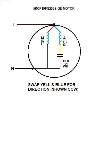

I picked up an old GE 5KCP19 motor and it has a five wire connection. Metering the leads, the continuity values are as follows.
Bk-Wht. 0
Bk & Wht-Red 92
Yel-Blu 17
Motor Ratings…
115V, 1650/1350 RPM, 35 Mhp, Cap 4Mfd. CW/CCW
Would appreciate connection help (simple diagram) so I can use it.

Well gentlemen, my puzzle is finally solved...
First things first, this is a PSC motor, not split phase, as there is no CF switch.
Here is my final diagram (that works,) both directions and correct torque.
After getting it running correctly, I took it over to the motor shop because I was (and am) confused about the commonality of the black & white leads,
and it doesn't matter if either or both are connected to the cap.
Without testing and just a visual look, he was uncertain as well and explained that usually they go to the source power, so it's still a question.
Additionally, I was quite surprised to see how much torque is applied when the 4MFD cap is installed. Without it in the below config, it spun fast but
could still be stopped with quite a bit of pressure on the shaft.
Anyhow, here's how it's configured to run in both directions. I was able to apply a 3PTT switch for reversing successfully also.
Thanks for all your help and sorry about any confusion from prior posts.

In regards to your 10 July post and diagram.
JMGotts said:
Note that the cap is not installed, just running straight wire.
The two windings will be physically displaced the equivalent of 90 electrical degrees.
With the jumper wire, the applied potential will not be displaced 90 degrees.
The two windings will be fighting each other.
It is not surprising that the torque is low.
