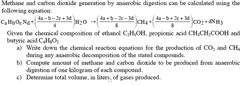

Dec 16, 2020 #2 SuperSalad Chemical Joined Mar 8, 2017 Messages 778 Location US What is your question? Andrew H. http://www.MotoTribology.com Upvote 0 Downvote
Dec 16, 2020 Thread starter #3 Isabelle Cumberbatch Student Joined Dec 1, 2020 Messages 4 Location TR in the picture ? Upvote 0 Downvote
Dec 16, 2020 #4 SuperSalad Chemical Joined Mar 8, 2017 Messages 778 Location US The exercise seems pretty straight forward according to the information given and the instructions for each part. For a, use the molecular formulas of each compound to determine your variable values and complete to reaction equation accordingly for each compound. For b, convert the kilogram into moles for each compound and complete the reaction equation accordingly. For c, assuming this is homework, use your results from b for n in the ideal gas law to calculate the volume at standard temperature and pressure Andrew H. http://www.MotoTribology.com Upvote 0 Downvote
Dec 16, 2020 #5 IRstuff Aerospace Joined Jun 3, 2002 Messages 44,904 Location US What have you done so far? a) looks pretty simple, have you done at least that part? TTFN (ta ta for now) I can do absolutely anything. I'm an expert! https://www.youtube.com/watch?v=BKorP55Aqvgfaq731-376 forum1529 Entire Forum list http://www.eng-tips.com/forumlist.cfm Upvote 0 Downvote
