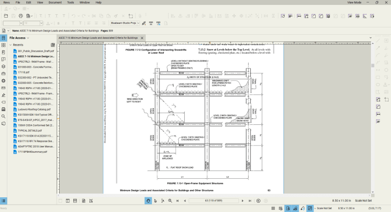

Snow loads shall be considered on all open-frame structures with flooring that can retain snow. Grating will also retain snow with cornicing effect. Please look ASCE 7-16 commentary C7.13 SNOW ON OPEN-FRAME EQUIPMENT STRUCTURES..

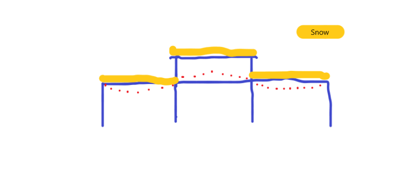

Originally I wanted to suggest two loading schemes, but I later thought that the more critical case would be snow on all exposed surfaces only, since the grating is likely affecting certain roof members locally (local critical), and without putting any load under the grating, it amplify unbalanced load effect on the roof.

Again, snow load on all exposed surfaces. See sketch below. (30 psf every where).

If the sides open, assuming the snowfall direction 45 degrees, snow loading shall be considered at levels below the top Level. ASCE 7-16 item 7.13.2 states 'Snow at Levels below the Top Level. At all levels with
flooring (grating, checkered plate, etc.) located below a level with flooring, the flat roof snow load shall be applied over a portion of that flooring level near any open edge in accordance with Fig. 7.13-1. The flat roof snow load shall extend from the upwind edge of the flooring a horizontal distance equal to the vertical difference in elevation between the level in question and the next floor above.'.

I don't think retired13 is correct. Reference Figure 7.13-1 in ASCE 7-16 as suggested by HTURKAK. You'll need to add some flat roof snow load under your platforming.
I should also add, I would design the beams and deck under the platform for the full snow load. The columns, footings and anything else supporting both platform and roof framing in that area would be the worst case between flat snow on platform plus the loading per ASCE7 Figure 7.13-1 or flat roof snow on the roof.

ASCE has addressed this issue in 7-16. They even produced a handy figure for various conditions.
