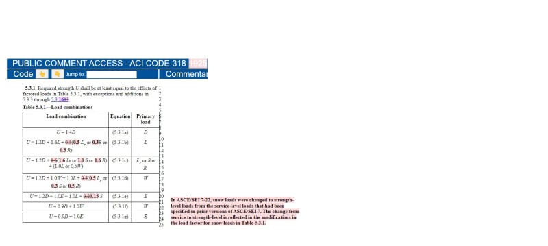

Agree with you two. In addition, I found ACI 318-25 public review on ACI website. You can register to read the draft version. Thanks for all Reponses.

Good news. The equations in Table 5.3.1 of ACI 318-25 for loads combinations have been changed to consistent with ASCE7-22. That is U=1.2D+(1.6Lr or 1.0S or 1.6R)+(1.0L or 0.5R. So the discussion is over. Thanks all.
