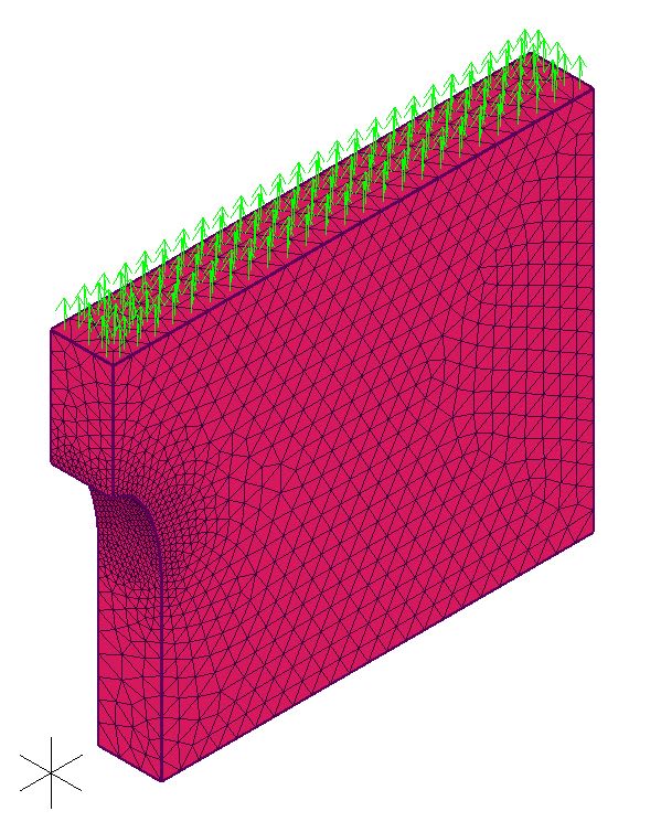

The image shows a plate with a 10mm wide slot. In this design the slot's end shape is a 20mm x 10mm ellipse. A uniform tensile load is applied to the plate's top surface (the narrow surface at the top of the image). Compared to a slot with an R5mm end shape, the von Mises stress is 23% lower.
Besides an ellipse (and possibly a polynomial), what other end shapes should I consider in order to minimize the stress? (I seem to recall a shape that approximated the surface streamline of a fluid flowing through an orifice but I haven't been able to find this again.)

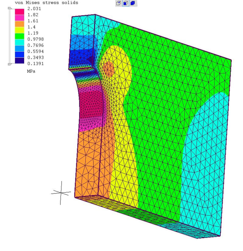

The highest stress occurs just in front of where the ellipse transitions to the slot walls, not at the tip of the ellipse (see the top FEA image). Therefore, a gentle curvature is needed in this transition region.

For clarity, the bottom FEA image shows the face load.

I see the load you are applying but what constraints are you applying to keep the part from moving?

I didn't want this discussion to get distracted. However, shows some designs that would use these slots. These resonator-horns are designed to vibrate at low ultrasonic frequencies (20 kHz for the sizes that I previously mentioned). The vibration direction is parallel to the slot axis. Stresses are highest where the linear slot walls terminate into the radiused slot ends. This is where fatigue failure often occurs. Therefore, I'm trying to redesign the slot termination for reduced stress.
The shown bar horns and block horns are only a small sample of essentially an infinite number of possible slotted designs. It would be difficult to try FEA on even a reasonable number of these designs in order to pin down a good slot termination. (Each design has to be tuned to the desired frequency and simultaneously optimized for other parameters.) Therefore, I'm just running a static FEA to get in the ballpark before extending to the actual horns. I know this has limitations but I'm willing to accept these limitations for the time being.
All slot stresses are well below yielding. Instead, failure is always by fatigue so the slot stresses must be kept below the fatigue strength of the material. (Aluminum doesn't have a fixed fatigue strength so just use a good factor of safety.)

The groove is an interesting thought. However, as you can see from the FEA, the stresses extend completely through the slot end. Therefore, while the groove might reduce the stresses locally (in the vicinity of the groove), I don't think that the interior stresses would be substantially reduced. This is especially true as the plate becomes substantially thicker.

What are the boundary conditions you are applying to the half section FEA model ?
How is the uniform tensile load really applied to the physical part?
