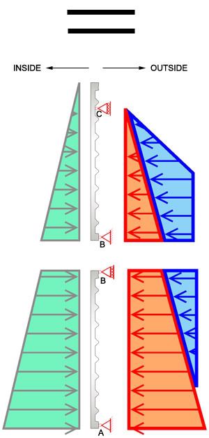

I would use the at-rest earth pressure, and if this is not enough, then resist the rest of the hydrostatic pressure structurally with the hoop stress.

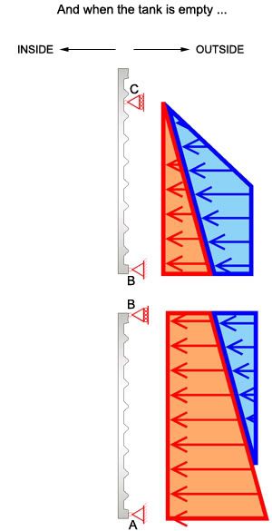

Wow! Looks complicated. You have a sloping buttress of soil that is counteracting the fluid pressure. Is it water (i.e., 62.4 pcf)? When empty, the earth pressure is determined by at rest conditions, which I would calculate aw 1.5 times the active earth pressure for sloping backfill (from DM 7). I would use full friction between the soil and the wall face, which in this case is your tank with a corregated texture.
Now consider what happens when the product is introduced into the tank: you begin to mobilize passive earth pressure. However, you will never mobilize the full passive earth pressure that's available to you. That's a good think as there could be strain incompatibility. I would guess your sloping at-rest earth pressure would be on the order of 45 to 50 pcf and the fluid content on the order of 60 to 70 pcf. Seems that it would all work out, eh?

Passive pressure, by definition, implies a mobilizing action on the soil mass. Concrete in general, and these walls in particular, admit very small positive strains (and their corresponding tension stresses). As a result, I think it is rare that the associated displacement -in the form of an increase in radius- can trigger mobilization of the soil mass. This, plus the sub-optimal steel/concrete ratio used in the standard walls makes me think that the analysis of these tanks must be done within the at-rest + compaction pressures domain (emphasis on compaction) as the soil never becomes aware of anything pushing into it. If it weren't like that, by the time the radial swelling derived from the hydrostatic pressure becomes significant, the wall will have cracked severely. I have verified that this is not the case when the backfill is properly executed. In such cases, the uncracked state of the thin walls is a strong indication of the pro-active role of the sloping backfill, such that:
[ul square]
[li]when the tank is empty, the circular concrete shell is fully compressed (this configures the most severe condition during the tank's lifetime).[/li]
[li]when the tank is filled, the circular concrete shell either has a residual compression or, at most, a very very small tension.[/li]

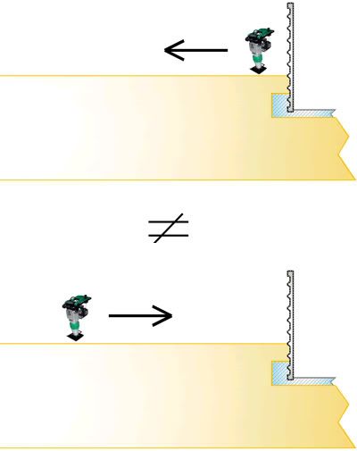

Add to that the compaction techniques. Each contractor seems to have its own sui generis way of doing compaction. E.g. How each lift is effectively compacted by the rubber-tyre rollers and rammers makes a difference. Is it carried out from the wall outwards or viceversa?. It's not the same. Neither are the resulting pressures on the wall. And that's just one out of many variables.

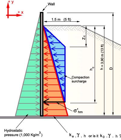

If we assume the soil's equivalent fluid weight = 50 pcf = 802 Kg/m3, then, does it mean that it will handle 80% of the hydrostatic pressure ? If so, the reinforcement will have to deal with the remaining 20%, won't it? I've done the calculations and the steel area needed to deal with 20% of the hydrostatic pressure is higher than the actual steel that's been used in these precast panels for decades. This sort of confirms my previous speculation in the sense that there must be a larger external pressure from the backfill acting on the wall. Maybe if we add the compaction surcharge to these 50 pcf we could fully compensate the hydrostatic pressure and even get some precious residual compression, right ?

I'm totally aware that although the stability of these tanks is acceptable (R < 15m or H < 3m), their safety coefficient is 1.00 at best. They have no strength reserve. Period. Even more, they're very sensitive to many imponderable soil-related things and as such I don't want to be held responsible for a concept I didn't even conceive.

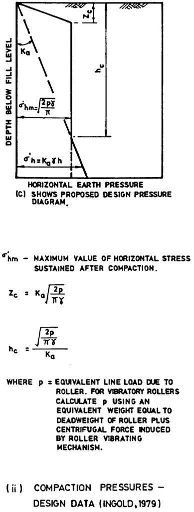

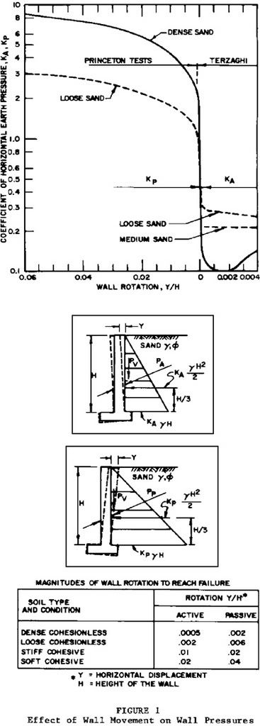

I think, generally speaking, what might be happening here is that I have a pressure diagram like this:
(Taken from Fig. 14, page 117 of the .PDF I found here.)
-OR-

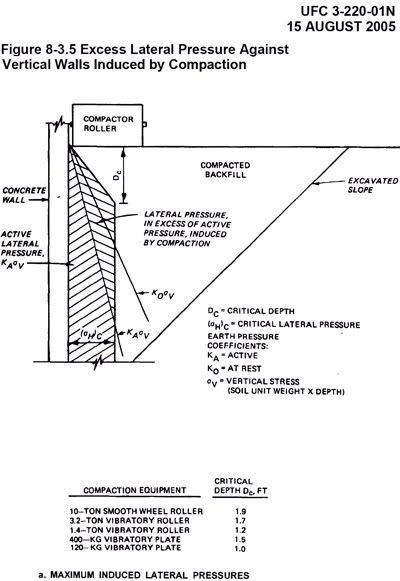

From page 8.47 of document ufc_3_220_01n.pdf downloadable from here we've got this diagram:
From the first graph, I see Zc / hc = KA2
Now, here are my doubts:
[COLOR=blue yellow]How can I guarantee that the Hydrostatic pressure + the pressure from the sloping backfill + the compaction surcharge will always remain < 0 ?[/color]
Additionally, will I use [COLOR=blue yellow]KA[/color] or [COLOR=blue yellow]K0[/color] ?
Throughout the thread we agreed to employ K0 and now we have Ingold giving precedence to KA over K0. [COLOR=blue yellow]So, do I still stick with K0 ?[/color]
I understand that the difference between KA and K0 lies in how much rotation the wall can tolerate, right?. [COLOR=blue yellow]But, how am I supposed to know beforehand the value of the rotation ?[/color]
For example, the parameter needed to enter Figure 1 from NAVFAC 7.2 (page 7.2-60) is the horizontal displacement Y.

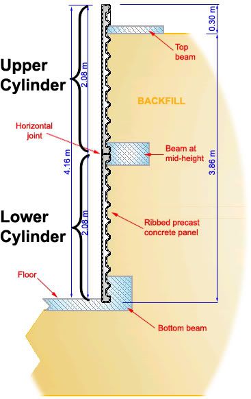

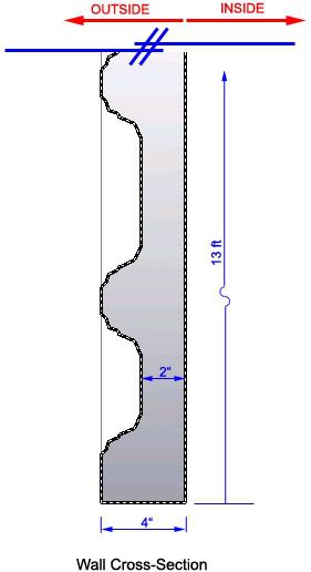

Remember from my previous post that the full height is achieved by stacking two cylinders:
Then, with the last picture in mind, [COLOR=blue yellow]where do I measure the horizontal displacement 'Y' so that I can use it in Figure 1? Is it the largest 'Y' from span AB, for example ?
And why not use Rankine's formula instead of Figure 1?[/color]
(OK, Rankine's assumptions of a flat, frictionless wall are not satisfied here)

[COLOR=blue yellow]So, what's the difference between Rankine's KA and the KA from Terzaghi's graph ?
What would be the value of Ingold's [&sigma;]'hm (or [&sigma;]HC for that matter) considering pneumatic rollers and rammers are employed for compaction?
And what about the value of Dc?[/color]

Whatever happened to the "keep it simple" request? I would consider compaction surcharge as a design stress that's transient. I would not consider it for the long-term performance of the structure.

right i design water retaining tanks etc. on I would say a weekly to bi weekly basis. Never ever rely on the backfill soil to 'reduce' the hoop tension or moments in the tank wall from the fluid pressure. Two cases 1) tank full no backfill 2) tank empty backfill. Youve just said that is what the code says! UK code same and clear. DONT RELY ON BACKFILL, TELL YOUR BOSS!
you also state precast panels cannot resist the forces, why? I have seen elevated precast tanks i.e. no backfill. Why use precast if they are not suitable for your size of tank? I'm sorry i can't emphasize enough how ridicolous relying on backfill to conteract forces from the full tank seems to me.
oh and also the 'worst case' will not be empty tank and backfill as you state as the tank wall will act like a big compression ring and if you try crushing a ring you'll see it is very strong. Can post a equation for compression resistance of circular tank wall on tuesday when I get back to work, but mostly I don't even bother checking it except in exceptional circumstances.

All the elevated tanks I've seen are small (R < 5 ft.), and so are the hoop forces. They're are a [&fnof;]unction(pressure, radius). Not a big deal in elevated tanks, like I said. Bigger tanks are a different beast. Let's do this quick exercise:
For R = 15 mts. (50 ft.), and, say, Height = 4 mts. (13 ft.), how do you put the steel bars needed to resist the hoop tension in a concrete section that's 4 in. in the thickest part ?. No sanitary coefficient (1.65) or load factor (1.7). No backfill either. Just the real service load. I see no way of fitting the required steel bars in this concrete section.
Yes, I'll really appreciate if you post the equation for compression resistance of a circular wall. I don't know, but I guess it must be directly proportional to the height of the wall and inversely proportional to the radius. You know, as the radius grows, the wall pretty much starts behaving like a "flat" slab and the cooperative "shape factor" diminishes.
Thanks !!
here the equation i was speaking (or typing) about. Concrete compressive stress = External pressure at depth H * diameter of tank, divided by 2[wall thickness+(modular ratio -1)* area of steel]. sorry in the way i've displayed equation I hope its clear. Not sure how this relates to codes as its from an old book based on permisisable stress design but the theory should hold up for you to prove that the tank is adequate.
On your sketch and question on steel I would say that your wall isn't thick enough for the application. As a starting point I take 100mm thickness for each 1m height and refine downwards from there (should get thinner). I understand that the ACI over with you specifies tanks over 10ft (3m ish) should have minimum 12 in thickness. If you increase your area for 4m deep tank you should comfortably get reinfocement in. Say 300mm thick, max ring tension (for fixed base) say 109kn ish, you would be on minimum steel to control cracking. Bear in mind these are very rushed knocked out figures and conservatively on allowable stress of < 130n/mm2 to keep cracking <0.2mm rather than direct crack width checking and is based on UK code! You will need to factor the load accordingly for strength checks but keep to unfactored for crack control checks. I have design book here given various tables and quite basic but useful guide, it s called Circular Concrete tanks without prestressing and I believe is from portland cement association. Address is in Illinois, Phone 708/966-6200 which means nothing to me as I'm not from US.
