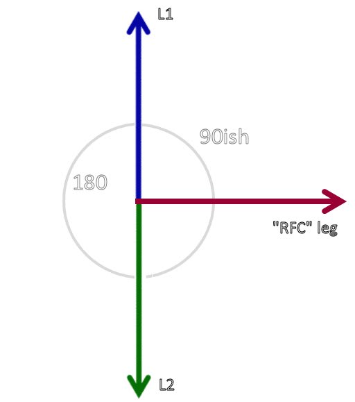

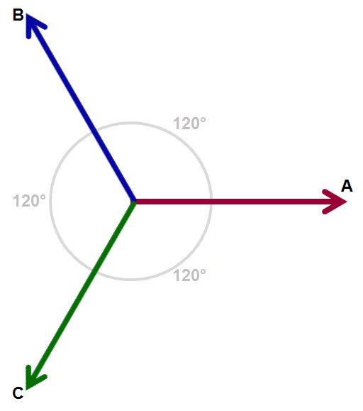

We destroyed* the 3-phase pump motor for our neighborhood swimming pool and wonder if the startup procedure we've been using for at least a decade needs improvement.
Property has only single phase 240V service so we have a mechanical phase converter to provide 3-phase power to pump motor. Current procedure is to start the phase converter then a few seconds later close a separate service disconnect switch to start the motor. Phase voltages from converter are 175V, 175V and 5V before closing 2nd switch. Then 240V-260V as expected across each pair.
Does the lower, unbalanced voltages cause stress on the non-rotating motor for those few seconds? If so, would it be prudent to add a device such as a 3-pole contactor that energizes the motor only after all 3 legs are within spec? Does such a device even exist?
