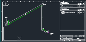

Hi, my friends,
I would like to ask about the single-line documentation on piping.
  • Is this document required for piping design?
  • What is the purpose of this document?
  • Which discipline(s)—piping, process, or others—are responsible for issuing and revising it?
Thanks a lot.
Eh?
You're going to need to describe what a "single-line documentation on piping" actually is. An example might help as well.
SO I would start with "What is this document?" And who is asking for it?
Only then can I work out what you mean, but maybe someone else knows what it is you're asking?
- Isometric piping drawings are not scale drawings. Single line drawing is not a standard terminology and used for dimensioned drawings and
which shows the size and location of pipes, fittings, and valves.
My opinion is , the single line drawings are not mandatory document.
