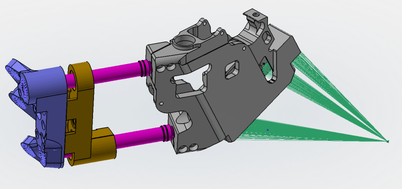

I am working on modeling an assembly where a shaft is held with a bolted split clamp.
I not sure what is the best way to simplify this connection in the FE model.
I currently have the parts set as bonded together, but I feel like that's not quite right. I am thinking instead of putting a really stiff CBUSH between the shaft (pink) and the clamp (grey), and then replacing the bolts across the split with equivalent springs.
But I am curious if anyone else has a better idea.
Also, I am using MSC Apex / Nastran for the modeling.

The loads across the joint should be mostly perpendicular to the axis of the shaft. There is no torsion in the shaft.

Yes and no, (tolerances notwithstanding) the shaft and the hole fit line to line, so once the bolts are tightened there will be some tiny amount of closing of the gap.

So here is a more zoomed out picture. The lavender piece on the left is grounded with some CBUSHs and the grey piece is being loaded by those RBE2s. I am interested in the overall stiffness/deflection of the design, the bolt loads between the brown & lavender piece and some stresses in the gray piece.
As far as the clamped joint is specifically concerned, I am not too interested in the it, but rather making sure that it is modelled in a way that doesn't add too much, or not enough, stiffness.
And really my question was meant to be a little more globally how do more experienced analysts handle simplifying clamp joints?
If you are interested in overall deflection, I would not bother trying to model the fasteners, assuming they are designed to be torqued up to provide clamp-up. For the clamp joints I would just tie the parts together; there shouldn't be much flexibility in those joints.
