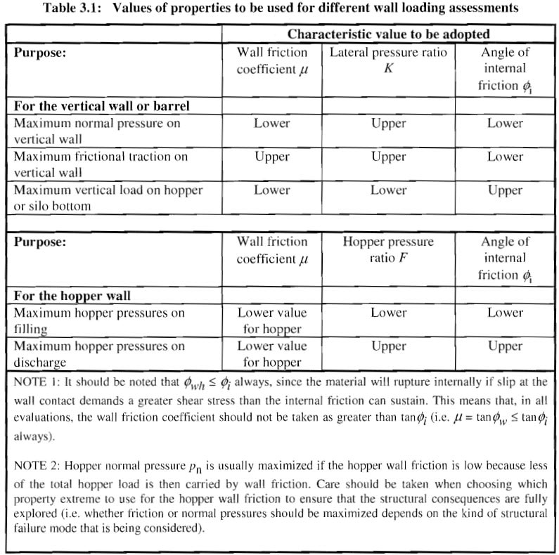

So I'm designing a steel grain silo with a capacity of around 33 m³ for the vertical part (class 1 according to EC 1991-4, under 100 t) - the cross-section is 2,0x2,6 m and the vertical section is 6,75 m high (so the grain would weigh around 300 kN at a unit weight of 9 kN/m³) . I've been studying the code for last 4 days and it has been quite overwhelming.
Is anybody here familiar with this particular Eurocode? I've calculated the frictional forces at eight different depths according to formula 5.2 in paragraph 5.2.1.1 in EC 1991-4 - now these results make sense - the net force seems to be quite realistic (around 165 kN I think). The frictional force pwf at equivalent surface level is 0,75 kPa and at the transition between the walls and hopper at a depth of 6,415 m it is 4,87 kPa. The formula from the code:
So is this the load I should add to my silo walls? I know it's not really linearly getting bigger but should I add it in my model in a way that it is a vertical surface load on my 2D element in model that has a value of 0,75 kPa at the top and 4,87 kPa at the bottom like a trapezoidal load?
Anyway, my real problem is another formula (5.7) in EC 1991-4 on the next page:
Now if I calculate these forces at the same depths as before for the frictional forces I get loads that are 0,13 kN/m at the equivalent surface level and 22,4 kN/m at the depth of 6,415 m. And the net force for this seems insanely high - like twice the force that the grain for this silo volume would actually weigh (around 665 kN?).
So what am I doing wrong? Any ideas? :)

I'm reasonably familiar with the code and have designed many silos and bins based of the loading in EC 1991-4.

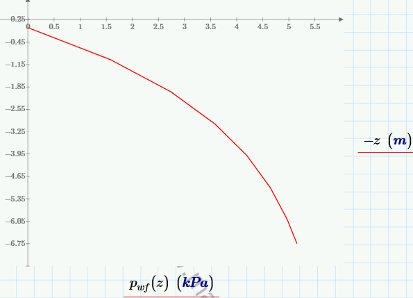

Applying it trapezoidal would be unconservative given the shape of the curve. If I am going to use vertical wall loads (often I won't bother) then I'll normally just apply the total amount uniformly as in most bin designs this would be conservative.
Here is my calculated curve:
Seems about right.... You have 9.2m wall circumferance which gives 22.4kN/m*9.2m= 206kN TOTAL WALL LOAD which is what I'd expect and also aligns with the calculated value of the pvf * A.
So your calculations seem to be correct by you seem to be having difficulty applying the loads.
All that said. Given this seems to be a rectangular bin, you barely need to worry about vertical loads for the bin design. It is the horizontal (perpendicular) wall pressures that will determine your design.
Thanks for great answer! But in your experience would`it be correct to assume hinges between the vertical connections of the 2D walls in the calculation model?
That would be conservative. But it depends on the stiffener arrangement. You'll likely need stiffeners for a rectangular bin this size.

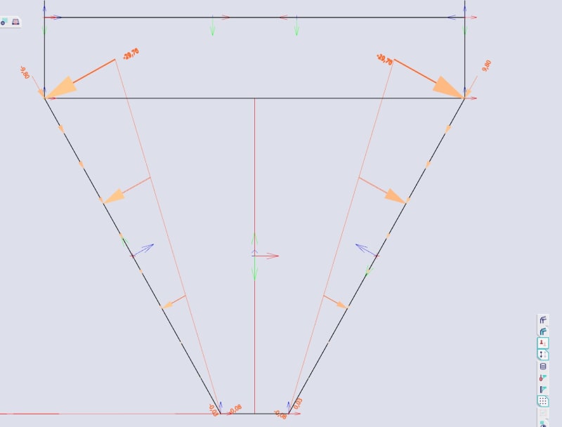

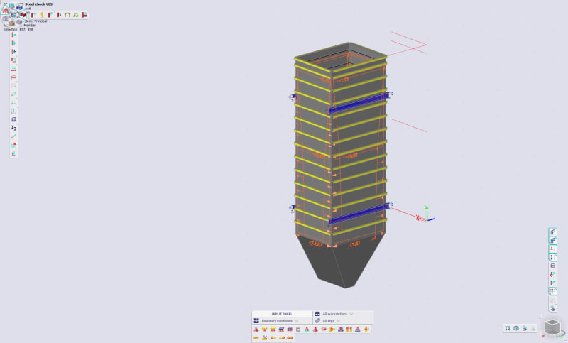

I've calculated the loads, took some time to make an Excel sheet for this stuff, and am now trying to apply them in my SCIA model. A screenshot below (don't mind the missing stiffeners for the hopper, I've not modelled them yet):
The lateral forces for the walls are pretty straightforward, but the other stuff is still confusing. Now if I would like to add the compression forces from the friction to the walls in a way that they are variable according to the depth on the walls then how would this be done - I mean at the transition between the vertical section and the hopper the force is 22,4 kN/m and at the top it's 0,13 kN/m - if I apply this as variable load in the model I'll get too large net reactions.
The other thing is the vertical pressure pvf - how to add this to the model? Or do the hopper load formulas in sections 6.3.2 and 6.3.3 in the code take that weight into account since pvf is in the formulas for the hopper loads?
UPDATE a few minutes later:
So to check the reactions I added friction forces on the walls as variable free surface loads (not as these compressive line loads) - they just act vertically. I then added the normal and friction forces to two sloped walls of the hopper, since I have a steep wedge hopper. And now the net vertical reaction from all this is 300,33 kN - which corresponds pretty much exactly to the weight and volume of the vertical section of the silo: V=6,415*2,0*2,6=33,36 m³, weight of grain 9 kN/m³ - total weight G=300,24 kN. But where is the weight of the filled hopper taken into account - the hopper has a volume of about 3 m³, so that would be additional 27 kN?
Sorry for the silly questions.
It seems like you are on the right track. Though you can probably reduce the number of stiffeners on the top of the hopper as the loads are lower.
Have you included the normal loads in the hopper? In the hoper the sides are no longer vertical so you have a vertical component in the normal pressures.
However, If you are chasing the loads to balance you are not going to get that if you are applying the material factor loads correctly. As the factors for calculating the wall loads are different from the factors calculating the pressure loads. This is deliberate because if you product/wall is low friction your hopper might take 70% of the load. Whereas if you product/wall is high friction your wall might take 70% of the load.
If you follow your calculations through you get 140% of the total load in the vessel. Which is fine for calculating vessel strength. Not fine for calculating the weight of the vessel on the supports.
As I said earlier for bin design I don't bother with calculating wall friction or vertical loads on my rectangular vessels. Especially if they are top supported like yours seems to be. The stress levels are inconsequential. The normal forces are the ones that will generally govern the design and are all resolved within the bin.
The unresolved vertical forces are simply the weight of the product&bin and will resolve via the supports generally putting only minor loads on the walls.
I did, the discharge loads are governing for this case. I used the formulas 6.24 and 6.25 from the code for this:
I did use the factors for the wall friction coefficient, lateral pressure ratio and angle of internal friction according to table 3.1.
The loads applied in the model for case "Maximum hopper pressures on discharge" for the hopper sloped walls:
But I haven't included the third case in the table, which is "Maximum vertical load on hopper or silo bottom" - I do not know how to include this in the model - to what section should I apply this?

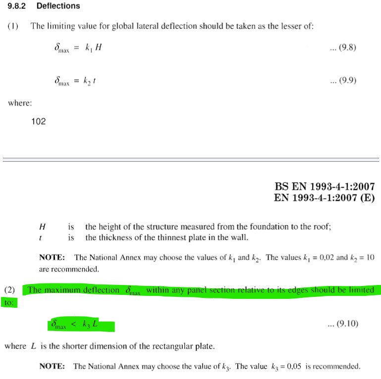

The other thing is local deflection of the walls - in EN 1993-4-1 formula 9.10 gives a limit deflection of dmax=k3L, where k3=0,05 and L is the shorter dimension of the rectangular plate - which in my case is 2600 mm. So this would mean a limit deflection of 130 mm, which seems way too much. A screenshot from the aforementioned code:

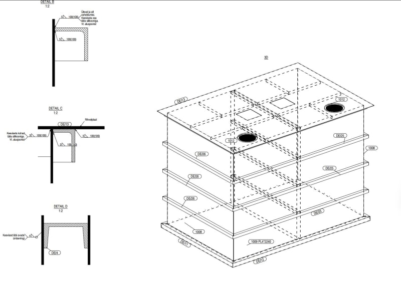

I think I'll use 4 or 5 mm steel plates as main walls
4-6mm would be my recommendation. It is a complicated balance of steel cost vs labour cost. In areas where labour costs are higher then 6mm and fewer stiffeners might be more economic.
You can spend excessive amounts of time trying to optimise a design, it probably isn't worth your time or your clients.
nivoo_boss said:
some angle sections (currently L70*7) for stiffeners.
That probably would work, strength wise. But you have raised deflection issues. But unequal angle say L100×50×6 might do a little better. I haven't done the calculations.
I'd agree that 130mm is "too much". The codes I follow don't dictate deflection and my clients aren't fussy. But I'd be trying to achieve at least half that amount.
Have a look at 100mm or 120mm deep stiffeners to achieve suitable deflection limits.
Even about 65 mm seems quite a lot to me :). So is it normal that the walls bulge out this much?
I'd agree that 65mm over 2600mm = 1/40 is very much on the high side of what is "acceptable". But who defines what is acceptable? Most of the deflection criteria we are used to as structural engineers relate to human or interior fitout interaction with the deflection. For a bin used for storage none of that applies (for my jurisdiction). If you ensure that your vessel is strong enough nobody will care.
Personally I design my vessels primarily for to suit FACTOR STRENGTH not for deflection. But I make choices to ensure that deflection is minimised by choosing deeper unequal angles. So for you case my design might be fewer stiffeners, 6mm plate and 125 or 150mm unequal angle. This will mean less labour costs and a stiffer bin.
**All the loads I use are factored loads. Either assessing strength or deflection. In reality the actual realised loads are probably going to be half the factored loads.

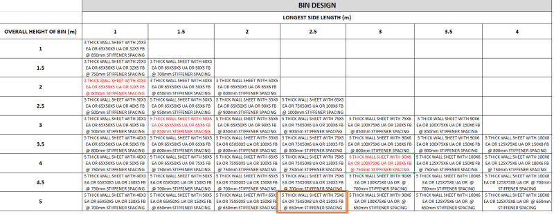

During some idle time I got a junior colleage to create a spreadsheet for this and produce a standard sizing for bins. It was 75% of the way there. I haven't had time to review it.
But this is the output:
(The chart only goes up to 5m bin height but 6m wouldn't be much higher pressure) Also eyeballing some of the values it seems like it might have deflection issues as the spreadsheet criteria was strength only.

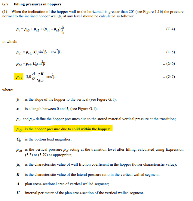

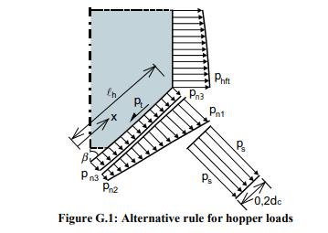

I recommend using the alternate formulas in the Annex G chapters if you want to use Scia or another FEA software:
with a clear figure how the forces should be oriented:
Pn1-Pn2 are the forces due to the material in the cilinder
Pn3 are the forces due to the material in the hopper
They are all based on the vertical pressure pvf (which doesn't need to be inputted directly, only if the floor is flat). All the forces that you need to input in your FEA model regarding the hopper are the ones on figure G.1
Hopefully this will help others in the future, I was struggling with the same questions you had and found no answers except this thread, so thanks!
