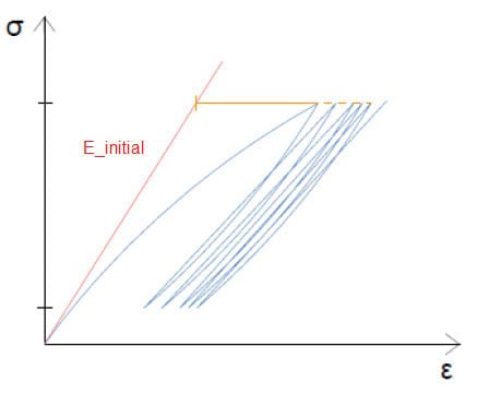

I have a concrete sample (preloaded), which has an initial Youngs Modulus (E). It is then loaded and unloaded several times. As you can see on the curve below the stress-strain relationship becomes nonlinear; should one not expect the Youngs modulus to be reduced? Reading previous notes it seems to think the youngs modulus increases the more times its loaded/unloaded.
