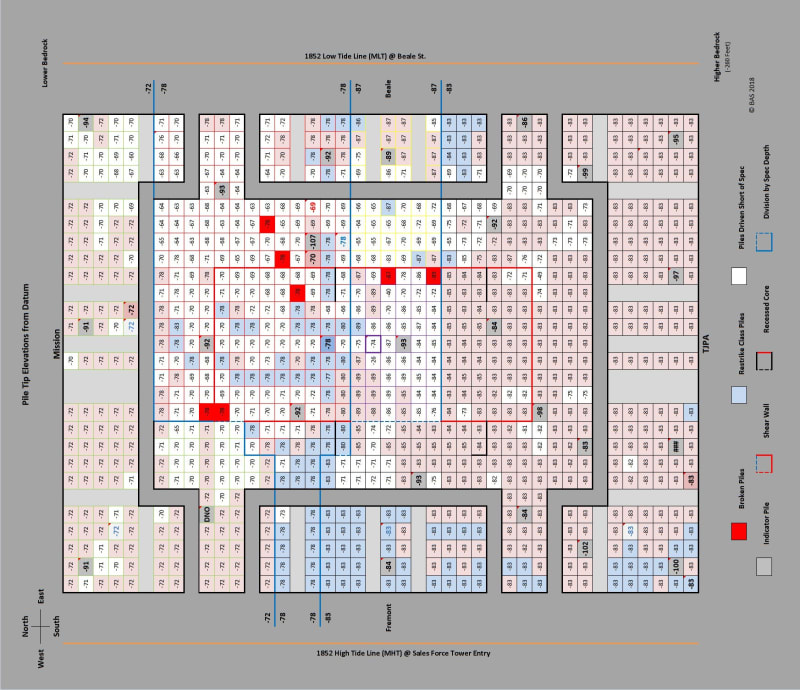

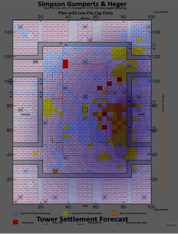

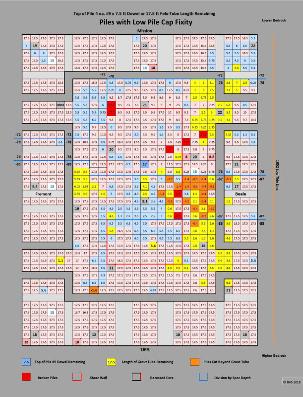

Attached is a pile map showing the depth of piles driven. The white piles are cut short, the blue piles are Re-strike quality piles. There are more (re-strike) piles on my map than listed by Treadwell & Rollo, as I added all piles with less than a hundred blows in the last 5 feet and then went through the list and added some piles with descinding blow counts; which appeared to have blown through the crust layer between Colma/Marine sand layer & a Marine Mud layer. It is the short cut piles that will prove the most resistant to the scheme proposed by SG&H.
Why can't I see my attachment?

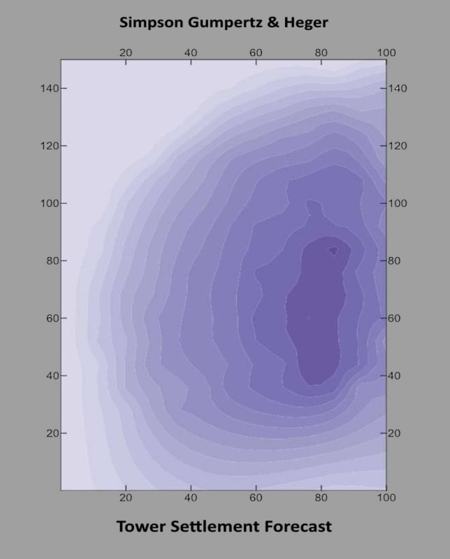

Updated Presentation by SG&H of the Settlement, Tilt & Repair to the University of Minnesota.

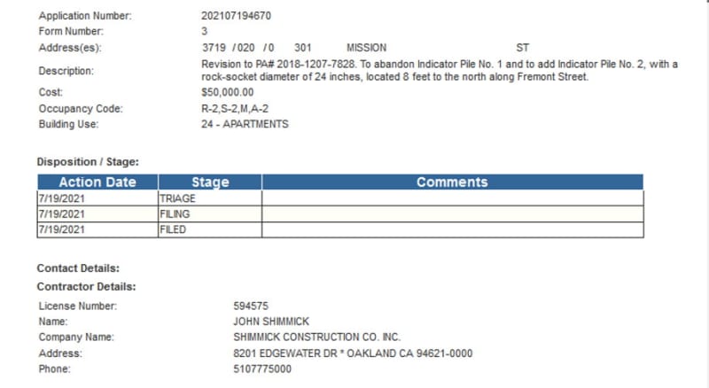

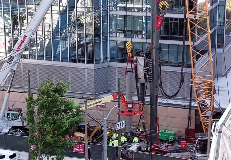

There are a few new slides plus some photos of work. Presently they are working on the "Indicator" pile on the corner Mission & Fremont streets.

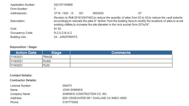

Looks like the perimeter pile work has had some hiccups. I'm a bit surprised this upgrade work is getting so little coverage from local news outlets. These permits were only posted to SFDBI's permit page for 301 Mission in the last week.

Interesting that their favorite costs for change orders are either $1.00 or $50,000.00.

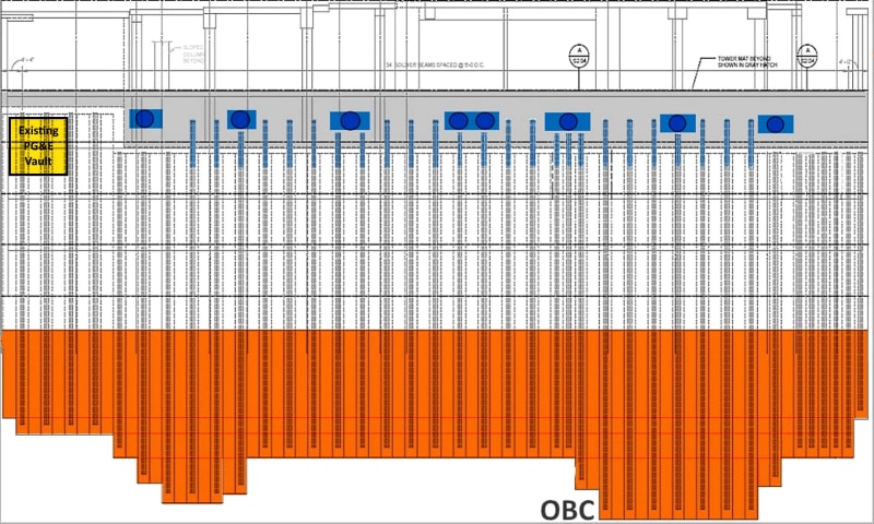

One of the entries to the Engineering Design Review Team's Comment Log (posted above Feb 25 2021) inquired about the results of Lera/Engeo's investigation of the current relationship between the tower podium shoring wall and the bottom of the towers mat foundation. The gist is that if the tower tilts back to the east by 2 inches, it will come to rest on the shoring wall. SG&H response was that the weight of the tower would then cause the 3 foot think 180 foot long 90 foot deep shoring was to settle. The 'experts' of the Engineering Design Review Team seemed satisfied with this answer, while completely ignoring that it results in an entirely new seismic condition. Just imagine a 10 foot thick concrete trampoline.

It needs to be remembered that when the tower was only 11 or 12 floors up, Webcor tied the east side of the foundation to the tower/podium shoring wall and then proceeded to stack 30 more floors on the tower (131 million pounds). All the while excavating a 56 ft deep hole in the ground immediately adjacent to the tower. From court records it is seen in emails that Webcor notified Treadwell & Rollo that the tower had shifted to the east shortly after tying the tower to the shoring wall. So the tower was sinking, drifting and the foundation tied to the wall by 25 each H-beams tied to the shoring walls soldier piles. Ron Hamburger is wrong if he thinks the shoring wall will settle if the tower comes to rest on the shoring wall. It has already borne a good deal of the tower's weight. Obviously not the entire 131 Million pounds was carried by the shoring wall.

From my post of May 26 2021, linking to a presentation by Ron O. Hamburger at the Univ. of Minnesota; I extracted the SG&H's forecasted settlement map and I overlaid it onto my Low Pile-to-Mat Fixity map, which I built in Excel. It is concerning. In a discussion before the SF Government & Oversight Committee's Hearings into the 301 Mission St. settling, the chair of the city's Peer Review team, Gregory Deierlein, stated that previous investigations by SG&H had not looked at the piling, so that was something they wanted to have reviewed. SG&H got the reinforcement in the top of the piles completely wrong. They is a worrying cluster of piles just outside the south-south-east portion of the shear-wall/core and near the south-east super-column that have only half of their 8 each #9 rebar in the tops of the piles. These piles were driven to refusal with 3 to 6 broken piles within the area with piles of reduced pile-head rebar. And then their is the buried PG&E vault.
The piles that were driven to refusal short of their design elevation represent "Hard End-Bearing Piles" in a field of soft piles. At least two engineers have speculated that piles under the tower may already have been damaged and that was without knowing any of what I've written. Since the tower is only 2 inches above the tower/podium shoring wall (10 inches of settlement), then these piles have either settled with the Old Bay clay or something worse had happened to them.
