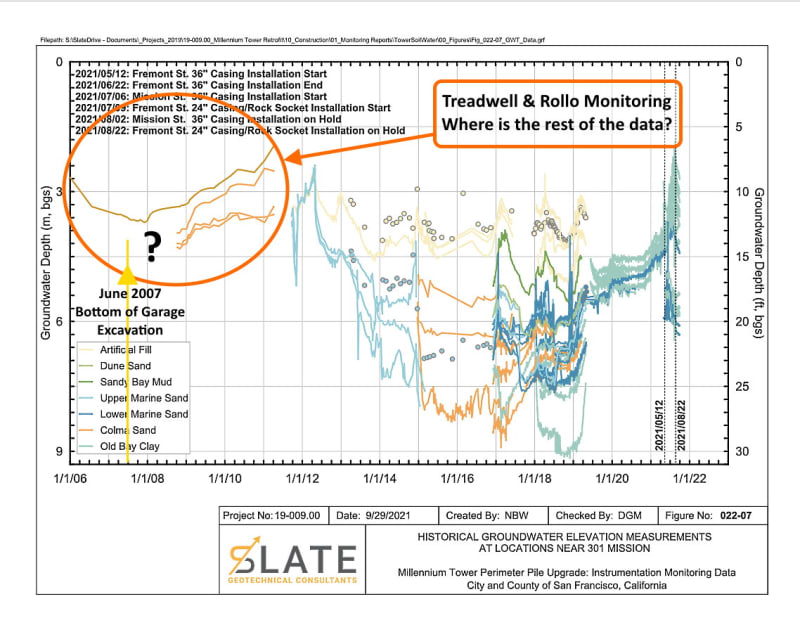

So far, the only use I have found for this chart is noting Mission Street Development/Millennium Partners/Paul Hastings LLP/SG&H/Slate efforts to continue to disguise the construction phase as problem free.

In response to epoxybot, it has been "tared out". For instance, there have been various reports of up to 6 inches dishing of the mat during construction but these have basically been buried. Hamburger mentioned that in his first ever draft report and then it disappeared for a long time. However, it has resurfaced in some of his recent comments in the comment log.
In response to hamjohn, the lateral roof deflections were about 16 inches to the west and 7 inches to the north when they started the PPU, so in each case they have so far used up about half of their own margin of safety. One of many big questions is why did they keep going so long?
