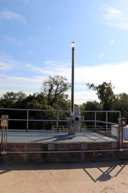

I'm designing the anchor bolts for a self contained sluice gate with a motor controlled actuator.
These are 10x10 gates that have a self weight around 20 kips. The stall load of the 7.5hp motor is 300 kips due to all the mechanical advantage of the actuator's gearbox.
I have the tension/compression loads due to water pressure worked out, but have a question regarding how the gate load is transferred to the supporting structure.
This morning, a mechanical engineer told me the self contained gate sends no load to the supporting structure other than self weight.
I agree with this statement for normal operations; but not for a 'stuck gate' scenario.

GC_Hopi - The gates have what I call a 'double stem'.
There is an inner stainless steel stem that is a tension element. As the actuator motor turns, it "screws the gate upwards". The load is turned 180-degrees in the motor and is sent down the outer stem casing, which is a compression element.
Below is a photo taken from the top after the permanent steel platforms were built. You can see the threaded tension stem inside the plastic raincover. At the base of the actuator you can see the much fatter compression portion of the stem.
No gate load goes to the steel platform at the top. The platform only carries the live human load.
Cool so the bracing would be important. The outer stem casing is easy to brace from the photo but the stem is tricker. They must splice the outer stem casing with flanges then insert stem guides. Gotta keep that Kl/r ratio down for the stem.
I'm coming around to Pham's line of thinking; where no stall load hits the anchor bolts (EDIT: INCORRECT). Below are my free body diagram and section cut.
I have reviewed the gate manufacturer's design calcs; and both the inner and outer stems can handle the 300 kip stall load.
The yoke beam is loaded via the outer stem, since the inner stem does not touch it.
Does everyone agree with these two statements:
1) As load travels down the outer stem, it lands on the yoke beam, which is supported by the left and right legs. Any load that makes it into the legs is then carried by the side anchor bolts. This is normal operating condition. The anchor bolts only carry the self weight of the gate.
2) In a 'gate stuck' while opening situation, the gate becomes stuck and the gate motor keeps pulling. The inner stem load near instantly increases to the full stall load of the motor (300kips). Since the inner stem can handle this load and the gate doesn't move; the motor stalls. Once stalled; the motor sends NO load down the outer stem to the yoke beam. (EDIT: That statement is incorrect- see further discussion) This happens near instantaneously. Perhaps the yoke beam sees a nanosecond of this load as the motor fails.
What do you think?
