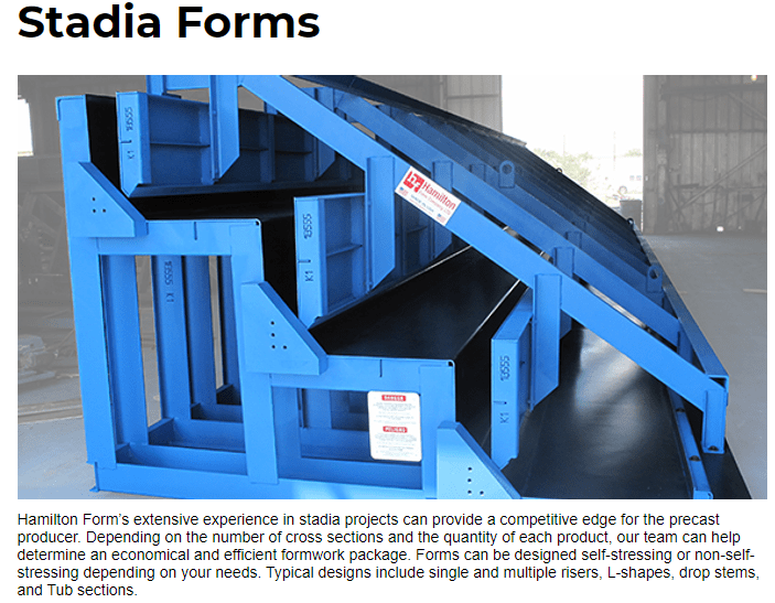

Hi!
I heard precast concrete stadium seats could be produced with self-consolidating concrete.
I wonder how they can be poured with different floor levels without cold joint
between first and second placement layers.
I am asking how I can make them monolithic concrete section with SCC.
-JRW
They can build their forms vertical depending on the length? Otherwise they would have to build an enclosed box that can withstand the fluid pressure.
Here is a typical form for precast bleachers. Usually made in single, double or triple risers depending on spans and arrangement.
Rotate the stairs so they are vertical and pour them like a wall.
