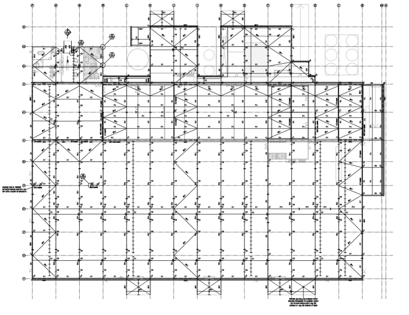

Do you folks put scales onto your drawings?
A contractor is bewildered that we don’t want them scaling dimensions.

JStructsteel said:@ Canpro, thats weird about no dimensions. My thought when doing a detail or plan, is 'can they build this based on the dims' Granted one time it would have saved me not to dimension.
human909 said:Around here we don't want them to be able to build it based on the engineering drawings. Engineering drawings are for the structure. Architectural drawings are for the dimensions. So engineering drawings will have very few dimensions except in places like typical connection details etc. Beam sizes or slab, wall thicknesses will be nominate on the drawing but generally not dimenssioned.
CANPRO said:I get what you're saying and I agree dimensions on the architectural drawings should govern. But aren't you concerned that the architect might move a gridline and increase a beam span beyond an acceptable limit (one of the examples that come to mind). Seems to me you'd want dimensions on your drawings just to cover your ass.
Enable said:Naa that's what max limitations are for
This issue occurred to me when I wrote my previous comment. Any gridline movement beyond a few a few dozen mm is unlikely an a significant change. Changes of any sort need appropriate engineering review.CANPRO said:I get what you're saying and I agree dimensions on the architectural drawings should govern. But aren't you concerned that the architect might move a gridline and increase a beam span beyond an acceptable limit (one of the examples that come to mind). Seems to me you'd want dimensions on your drawings just to cover your ass.
I do agree that basic dimensions are helpful in a set of structurals. However I do see some issues. If I design a building that has 7000mm portal bay lengths and then that gets nominated on the drawings. Further down the line due to a minor change in the sheeting used or similar the end bay might require the bay length to be 6970mm spacing between grid lines. That is not a change that the engineer needs to worry about but if 7000mm is still noted on their drawings then it is a complete reissue.CANPRO said:I believe a proper set of structural drawings requires some basic dimensions (grids/elevations)...and notes indicating the drawings aren't to be scaled, the dimensions shown are not to be used for construction, and the architectural drawings to be used for dimensions.
I'm also on all sides of the issue as we design and build and it isn't uncommon for us to use external consultants. Overall I'm used to engineering drawings not having dimensions, though I am grateful if gridlines are dimensioned.Enable said:I'm on all sides of this issue. I'm a contractor / delegated designer / EOR in certain cases.
human909 said:I do agree that basic dimensions are helpful in a set of structurals. However I do see some issues. If I design a building that has 7000mm portal bay lengths and then that gets nominated on the drawings. Further down the line due to a minor change in the sheeting used or similar the end bay might require the bay length to be 6970mm spacing between grid lines. That is not a change that the engineer needs to worry about but if 7000mm is still noted on their drawings then it is a complete reissue.
I see architecturals often revised for minor details during the project as RFIs are raised about minor finishing details. Engineering drawings are less commonly revised (unless the engineers have been particularly slack).
CANPRO said:But the max limitation would need a dimension would it not? Maybe I'm misunderstanding, but I'm picturing with everything on the drawings dimensioned followed by "MAX".
I understand your view points and have similar range of experience as a contract, delegated designer, and EOR. For per personally, I believe a proper set of structural drawings requires some basic dimensions (grids/elevations)...and notes indicating the drawings aren't to be scaled, the dimensions shown are not to be used for construction, and the architectural drawings to be used for dimensions.
