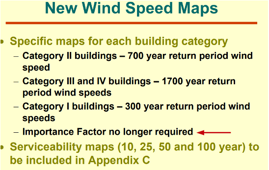

Retired -- that muddies the water a bit, because of the difference in wind load philosophy starting with ASCE 7-10, when wind loads are now expressed at ultimate/strength/500 year levels instead of the previous service/50 year levels used in ASCE 7-05 and UBC. As such, the ASCE combination and UBC combination result in the same wind load effect, although ASCE 7-10 applies that 1.5 factor of safety by decreasing the dead load, while I suspect UBC requires that factor of safety separately.

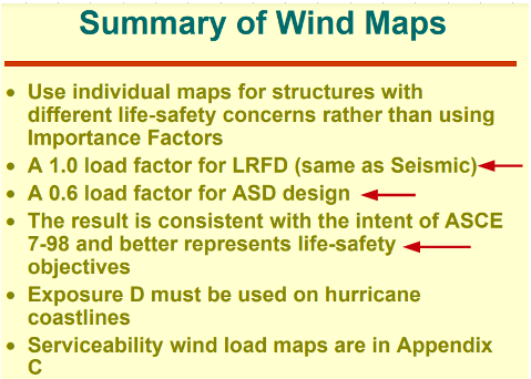

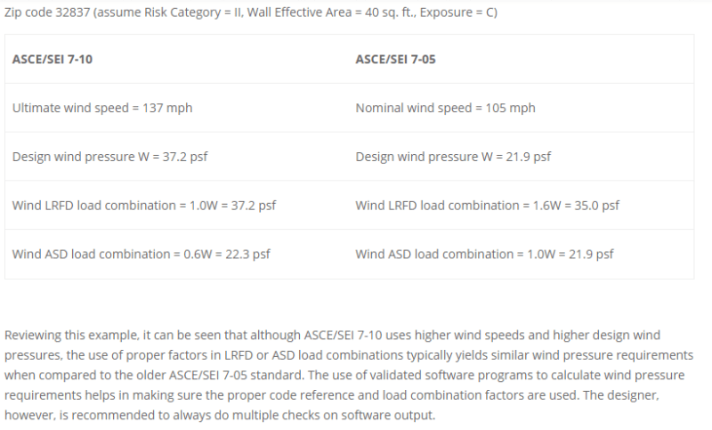

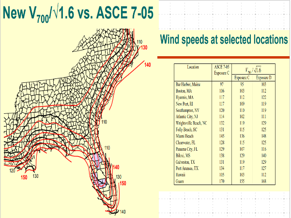

ASCE7-10 has redraw the wind map. but did not result in 50% increase in wind pressures that would justify the lower of safety factor from 1.5 to 1.0. [incorrect statement] See presentation below for changes, and comparison of 2010 & 2005.
Another example of comparison between ASCE7-10 and ASCE7-05.
Yes, as I said, same wind effect.
just call me Lo.
Lo,

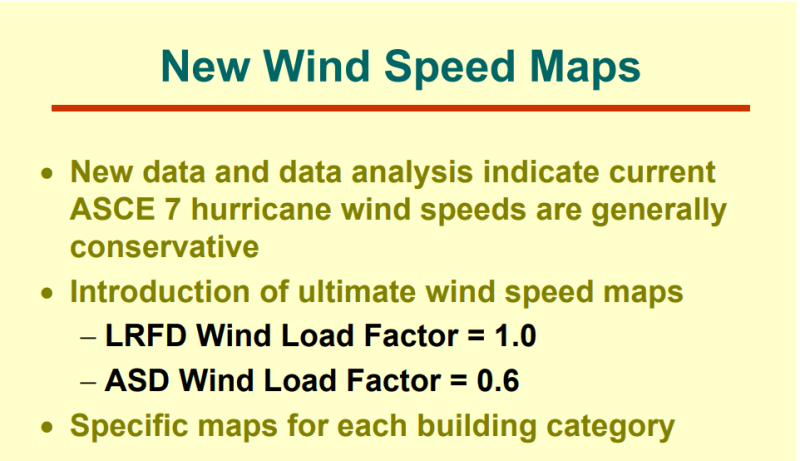

You are correct. 1.5 FS does not apply to ASCE7-10 wind provisions, as the pressures remain close, but the dead load factor has changed from 0.9 (on 7-05) to 0.6 (on 7-10).
retired - you're comparing LRFD dead load factor for uplift in 7-05 and the ASD dead load factor for uplift in 7-10.
For ASD, 7-05 combination is 0.6D+1.0W (with W calculated at a 50 year MRI) and 7-10 combination is 0.6D+0.6W (with W calculated at a 700 year MRI). The end result is essentially the same, and both yield a factor of safety of 1.67.

Good catch. Below is the revised sentence.
"1.5 FS does not apply to ASCE7-10 wind provisions, nor previous editions since 7-98, which had reduced the dead load factor from 1.0 to 0.6. I don't believe there was drastic change in wind load until 7-10."
