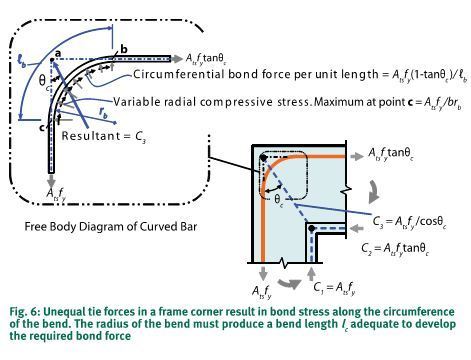

CELinOTTOWA said:
Standardisation of hooks in AS 3600
Thanks for the link. This includes some useful info alright. My take aways from it:
-Transverse bar does improve pull out capacity, especially for small round bars.
-One you are into real bars (say 12mm deformed), a standard hook with its corresponding small radius bend is sufficient to break a bar, even though we only use 50% of that in practice. Which raises the question - why bother with these big radius bends designed to limit bearing stresses if we know a tight bend will break the bar? Why not maximise the length of straight bar into the concrete?
Kook has made excellent arguments.
Note that 2006 and 2010 Caltrans standard retaining wall details show larger radii for the stem to toe reinforcing hook. If you can look beyond the politics and disfunction of Caltrans, realize that they still have more than a few very good senior engineers and good standard details, with a lot of full scale testing. They obviously changed the ACI std hook detail with intention.
ATSE,
Do you know why they changed to large radius? What do their results show? Stronger joint? Better ductility? Etc
I'm interested to know why gentle bends are so beneficial when tight bends alone happily break bars.
Tom,
Not sure about the 9" radius - seems very large. But 3 diameters (ACI 318 Table 7.2) seems fairly tight.
Kook and others above can articulate the "why" better. No doubt that concrete crushing stresses are lower at the inside of larger radius bend.

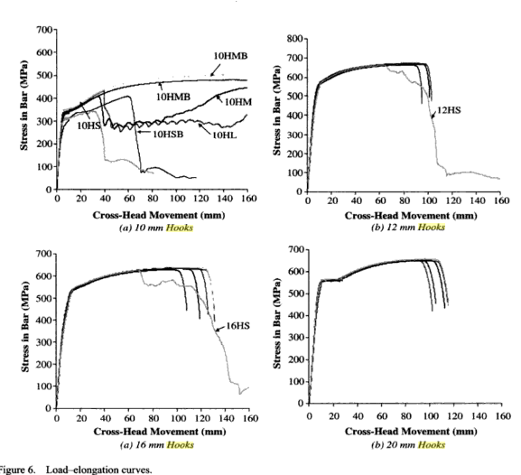

2) Because Wheeler's primary interest was beam stirrups, his testing regimen stopped at #6 bars. Concrete crushing inside bends is known to be more critical with larger diameter bars as one might encounter in larger retaining structures.
Is it? According to the AS3600 tests the bigger bars worked better. Look at the graph. The bigger bars killed it - even with a short extension length. It was the small soft bars that needed the cross bar.

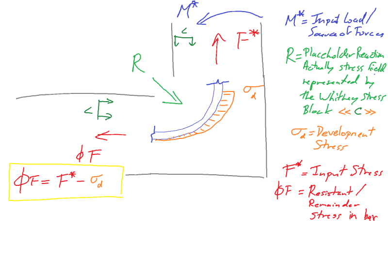

Actually I now think Kootk is entirely wrong about the development into the footing. I'll do a sketch and send it through later today... There is no doubling of the force at all.

Here:
CELinO said:
...but must commend you for your masterful treatment of the subject otherwise (above)
Thanks. Not sure how much of this still holds but, regardless, it was kind of you to say.
CELinO said:
I agree, but the way you show it is more analogous to a detailed pulley problem (where you include friction and other internal forces).
Yes, the joint is in fact very much like that.
CELinO said:
Unless I'm mistaken, I don't think you're saying that both ends of the bar carry AsFy, but that's what you showed.
That is correct. The tension on the vertical leg could potentially take on any value from zero to As x fy. Same goes for the tension on the horizontal leg. I would argue that, in many conventionally proportioned retaining wall situations, both the vertical and horizontal tension forces would approach As x fy (economical proportioning).
If you examine my sketch in greater detail, you'll see that I included a starred note at the top indicating that I'd shown a simplified condition and acknowledging that As x fy represented the upper limit of applied bar tension (equal utilization. I also said as much in the verbiage accompanying that post:
KootK said:
In the general case where entry and exit bar tension is unequal, some force transfer does occur via bond stress.
Let's not get hung up on the 2X business as that is not the salient point here. The salient points here, in my estimation, are these:
1) The concrete bearing stress that would accompany a standard, development only situation, would reflect a zero value for horizontal leg rebar tension.
2) Your typical retaining wall closing joint will have a non-zero value for horizontal leg rebar tension.
3) The non-zero value fro horizontal leg rebar tension in #2 will add concrete bearing stress in addition to that associated with #1.
4) #3 implies that, just because a standard hook is good enough to break the bars in a pure development situation, standard hooks may not fully address concrete bearing issues in a closing joint situation.
CELinO said:
Do you see the distinction?
I'm afraid that I do not. As I see it, flexure in the footing demands horizontal bar tension at the joint just as flexure in the stem demands vertical bar tension at the joint.

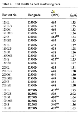

Not sure to be honest. I don't have any readily available research to support my claim. Nor can I remember where I picked up my assumption. Before proceeding further, I should mention that I only have access to a partial google doc on this: Link. I don't have the original proceedings document nor Wheeler's original research paper. If you're working from better information, do let me know.
The data that I have access to is shown below. To me, it appears that the larger bars did not outperform the smaller bars. Rather, all of the deformed bars tested (#4, #5, #6) reached the same ultimate stress. That being the breaking stress of course. Moreover, because the failure mode was generally bar tensile fracture, the tests don't really say anything about differences in concrete bearing stress. One would either need to measure the bearing stress directly or modify the tests to induce bearing failures in order to make inferences about the relative performance of the various bar and hook geometries with respect to concrete bearing stresses.
Regarding the specimens without crossbars, NONE of the SMALL bars broke, MOST of the MEDIUM bars broke, and ALL of the LARGE bars broke.
