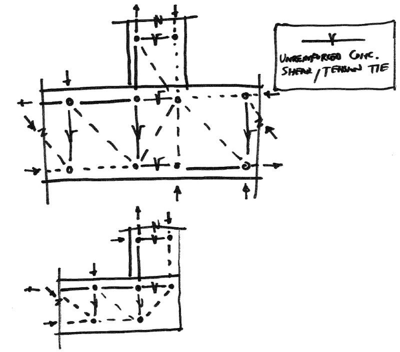

It still needs to be a moment joint but it can take a different form that, while not particularly efficient, may not require the vertical reinforcing to round the corner of the joint. See the strut and tie representation below.
If the potential shear issue is well understood, I am still confused about the second potential issue( on the left side of the draft) Could you explane to me more, please?
In the case that we have a shear wall connected to a thick mat, should the vertical reiorcment round the corner or not?

I don't think that it's well understood at all. Consider:
1) Just look at the diversity of opinion here.
2) I made up my own STM for this and have yet to see another in print other than similar stuff for post-installed rebar (attached).
I'll try:
1) On the left, your effective flexural depth is reduced to correspond to the level of embedment of the wall stem bars. Normal design practice would use the full "d" of the footing.
2) On the left, you have a concrete anchorage situation with regard to the wall stem bar embedment. It kind of depends on how one chooses to look at it but I view it as a sort of shear failure left of the stem that would involve a depth less than the full depth of the footing.
3) At the leftmost node on the bottom, there's a bursting tendency that exacerbates the demand on the "tie" at that location. In most retaining wall designs, the "ties" will be non-existent as rebar. Rather, the ties will represent footing diagonal tension shear (Vc). Thus, ultimately, we hav eanother source of shear issues.
I've attached a few pages from a clever document from Hilti Europe for post installed rebar situations. It covers a lot of the same concepts. I'm hoping that you will find it helpful.

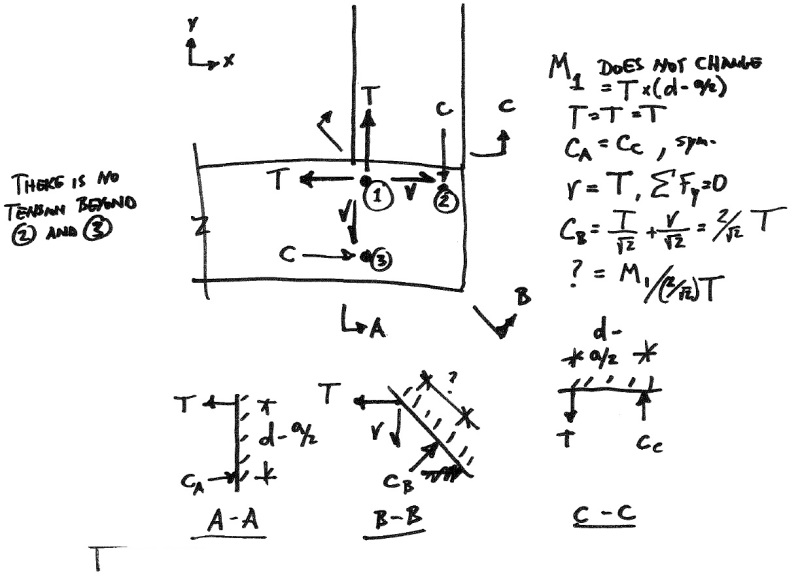

As for the strut tie models, I continue to have problems at the tension tie terminations as well as dealing with the unreinforced, concrete shear/tension ties. With the understanding that a bar being developed transfers its tension into the concrete via shear then something like this can be proposed (and also adds credence to the shear being the limiting factor). Without the shear tension ties, many of the strut tie models above and published in books do not work because the tension terminations are shown way to close to the face of an element to allow for the correct tension development even with a hook.
Update - made shear ties orthogonal and shear struts diagonal.
Below is my attempt to show why tension around the bend doesn't exist for the open corner condition. The tension in the reinforcement is effectively 0 when it gets to the hook/bend.
1) Just to clarify, this argument would only apply to the case where there is no footing toe extension beyond the wall. With the toe extension, I believe that it's a different story and there is definitely tension force in the bar as it rounds the corner.
2) For the joint that you drew, and presented macroscopically, I would agree that there is no force in the bars around the bend. However, research (some quoted above) has clearly demonstrated that having hooks, hoops and such drastically improves the performance of such joints. Logically, that could not be the case if there was no "tension around the bend". The tension around the bend is a static necessity for rebar details like this to perform.
