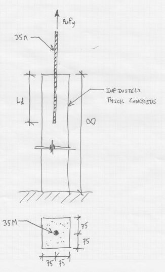

While I'm anxious to get to "done" as well, I feel that I've come up with one more salient argument that hasn't yet seen the light of day.

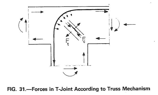

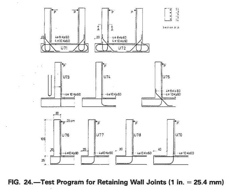

Below, I've included a blurb from MacGregor's text which references a related ACI clause. Essentially, it's a fundamental statement of what reinforced concrete is. Not just concrete mind you. REINFORCED concrete. The fundamental principle being that, in reinforced concrete, flexural tension is passed from reinforcing bar to reinforcing bar without utilizing concrete in tension other than, perhaps very locally at lap splices. It's an important distinction because, as has been pointed out, concrete does have some tension capacity that can be mobilized in certain cases (app D etc).
Here's a summary of my thinking with this:
1) I went with an L-shaped retaining wall because getting rid of the heel simplifies things in a helpful way.
2) If all that matters is development, then I would argue that cases 2 & 3 are effectively identical.
3) Case 1 would pass the RC concrete litmus test indicated in the blurb at section A-A.
4) Neither case 2 nor case 3 would pass the RC concrete litmus test indicated in the blurb at Section A-A.
5) While cases 2&3 would have some capacity as a result of concrete tensile stress, that capacity would be greatly reduced.
6) I've never encountered a design method that relied on concrete in tension at the moment joint.

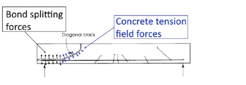

Fundamentally incorrect. Stress development IS concrete tension. Specifically it is perpendicular concrete tension along the lengths of the bar. It's not simply some magical "bond" between the bar and concrete which is unrelated to the concrete tensile-rupture. Read the Gilbert link KootK posted about. As gilbert puts it - "bar anchorage is concrete tension". That's what it is.
A straight bar embedded in slab or tube of concrete (TME and KootK sketch) is irrelevant to our problem because the applied actions and failure plane are perpendicular the anchorage tensile forces meaning you can forget about them.
In our cases with hooks into a heel the anchorage tensile forces align with other tensile forces, and thus it's now critical (hence the poor joint efficiency). The concrete is preloaded with tension and hence the bars cannot develop. They can no longer induce the tensile forces needed to develop the bar because the concrete tensile capacity is almost used up already in those areas. As CELinO points out, developement is much worse in tensile zone. It is much harder to develop the bar in these tensile zones. In the case with the hook turning into the toe there is great confinement so anchorage is much better.
This idea that development is merely a bond force which is unrelated to rupturing of the surrounding concrete is ridiculous. It is simply ridiculous to call bars which are tearing up concrete as being "developed bars". A developed bar is one that DOES NOT rip up the concrete before it yields. It is a bar that does not overwhelm the concrete's tensile capacity prior to it yielding.
Tomfh said:
Read the Gilbert link KootK posted about. As Gilbert puts it - "bar anchorage is concrete tension". That's what it is.
Gilbert's just talking about the perpendicular splitting forces that develop along bars as they anchor, slice, and develop. That's something that I've acknowledged previously and simply isn't part of the primary structural action.

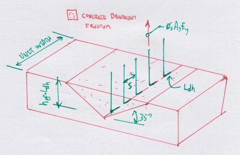

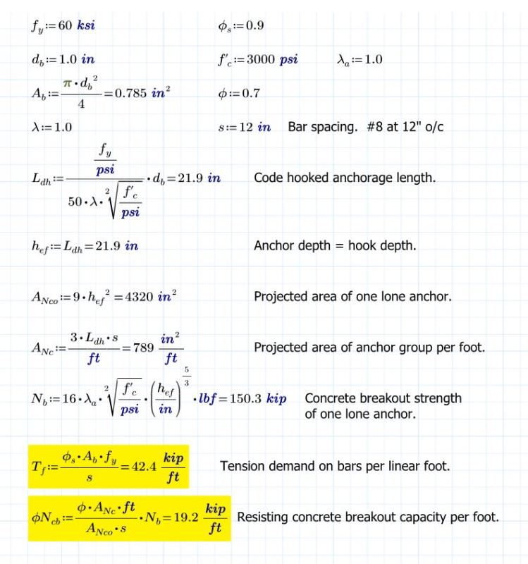

Using ACI appendix D, I ran an analytical experiment. I put it together quickly so, no doubt, there's a mistake in there someplace. I'm sure that someone will point it out for me in short order. For now, here are the details:
1) Went with #8 bars at 12" o/c as a representative retaining wall case.
2) Calculated the tension demand along the bars in kip/ft.
3) Calculated the resisting concrete breakout capacity, also in kip/ft.
4) The capacity in this instance is less than half of the demand.
5) I used phi = 0.9 on the bars. To rupture a bar, phi = 1.25 is probably more apt.
6) It plays out better for smaller bars and worse for larger.
If you do this same exercise for a single bar, all by it's lonesome, you usually will have enough breakout capacity. That's not because development guarantees breakout capacity however. Rather, it's just how the numbers pan out. When edge or group conditions apply, development often will not guarantee adequate breakout capacity, as seems to be the case in this instance.
I don't agree you've acknowledged it because you are characterizing the tension as "just a perpendicular splitting force" and are saying it's has nothing to with overall failure.
The perpendicular tension is sometimes related to primary failure (i.e. global forces in the concrete), hence it being more difficult to develop a bar through a tension field. Hence the hook in detail (a) being far less developed than the hook in your "abominable" detail. In detail (a) the perpendicular splitting forces are pushing against concrete that's already wanting to pop out, and the joint fails early. In the abominable detail the hook wraps back into the confined core, where the concrete isn't already at breaking point.
Your rod-snapping and frustrum-pull-out examples do not have global tension forces aligned with the bar perpendicular splitting forces, plus the geometry ensures the concrete wont split along the bar, so it's cheating to cite these as proof that splitting along a bar is entirely unrelated to so-called "primary failure".
I'm having a hard time parsing out what you're trying to get at here. How about a sketch or two?
Cheating huh? I thought that one of your arguments was that developed bars can't be pulled out of concrete by way of concrete breakout. I've show an analytical example of that assumption being inaccurate. Seems perfectly valid to me.
What I'm getting at is that anchorage tensile forces aren't just "perpendicular splitting forces" that are unrelated to overall failure. Yes in most occasions these perpendicular splitting forces do not interact critically with the concrete tension forces (e.g. your go to example above), but in many occasions they do, and failure occurs. As CELinO puts it, the anchorage needs to grab onto something. If that something (concrete tension capacity) is already used up then you have problems. here are a couple of examples. one a regular beam, and the second our joint cases.
