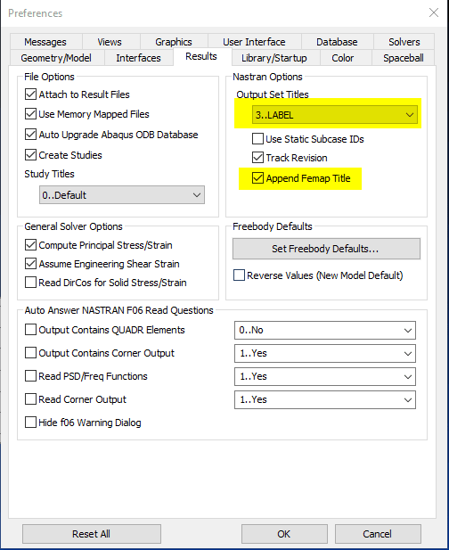

Hi guys! I'm opening this thread again. I've always had the problem with the Nastran Options - Output Set Titles.

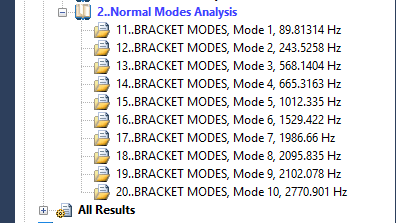

When I have a Multicase Static analysis, it's convenient to configure the Output Set Titles to "3.. Nastran LABEL", but when I jump to Modal Analysis, the outputs are just " Untitled", so I have to check the .f06 file for natural frequencies or change the Output Set Titles to "0.. Standard".
Is there any automatic way to get as output titles for Modaly analysis the natural frequencies and still use the Output Set Titles to "3.. Nastran LABEL"?
Thanks in advance
Try using the "append Femap title" under the results tab in Preferences
