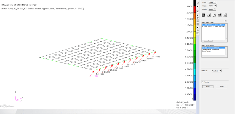

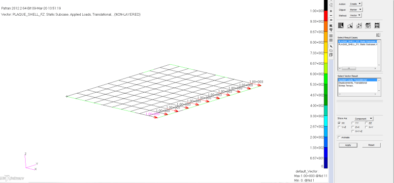

Hi everyone,
I generate with a firt static analysis the output files :
plaque_shell.DBALL,
plaque_shell.MASTER
plaque_shell.neut
with the nastran command :
nastran20131 old=no smp=2 news=no scr=no memory=8GB smemory=3200 /home/user/plaque_shell/plaque_shell.bdf with the bulk file below :
Code:
$ BULK TO BE USED TO CREATE THE .DBALL & .MASTER OF
$ THE MODEL FOR RESTART PURPOSE
ASSIGN OUTPUT2 = 'plaque_shell.neut', UNIT = 12, FORM = FORMATTED
SOL 101
INCLUDE './DMAP/dmap_modele'
CEND
TITLE = PLAQUE SHELL
ECHO = NONE
SPC = 1
DISP = NONE
BEGIN BULK
$ Use PARAM,POST,-1 to have a no empty .neut file
PARAM,POST,-1
$ BOUNDARY CONDITIONS
SPC1     1       123456  1       12      23      34      45      56
         67      78      89      100     111

I have submit Fx load first and then Fz.
When I plot Fz results, and particulary Applied Loads, Translational, the Resultant it is a combination of Fx component and Fz component as you can see in the attached picture
Display Applied Load Resultant
Display Applied Load Fx Component
Display Applied Load Fz Component
I am not sure I understand. Normaly the Applied Load must be pure Fz and Fx component must be zero.
Apologies nekcorp, I gave you bad advice! I didn't notice that both of your runs use a FORCE ID of 1 to apply the load. It seems that the restart process keeping the Fx load in the MASTER file after the Fx run, then it gets combined with you Fz load in the Fz run.
Try using "RESTART VERSION=1,KEEP". This will make sure you're only ever using the original MASTER, and specifying KEEP will prevent Nastran from deleting it.
