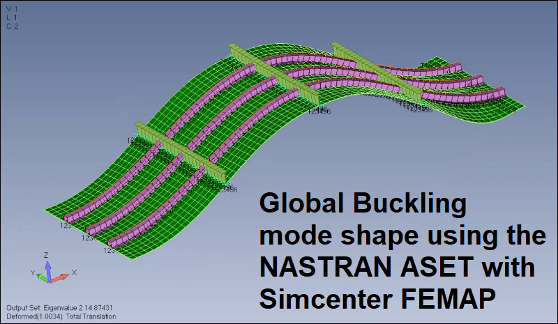

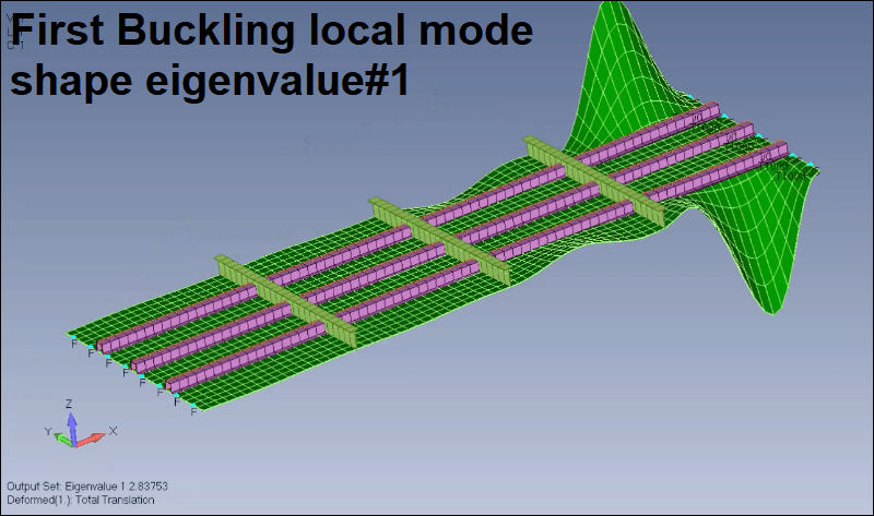

Oct 12, 2023 #1 Giang123 Aerospace Joined Sep 14, 2023 Messages 16 Location VN How to switch from global mode to local mode when solving normal mode in MSC NASTRAN?
Oct 12, 2023 #2 SWComposites Aerospace Joined Nov 6, 2000 Messages 3,743 Location US Maybe provide more details on your model and what you are trying to simulate. Upvote 0 Downvote
Nov 9, 2023 #3 BlasMolero Mechanical Joined Aug 12, 2009 Messages 932 Location ES Dear Giang123, Please see the attached video that shows how to extract the local & global buckling eigenvalue modes using the ASET with Simcenter FEMAP & NASTRAN, thanks!. https://youtu.be/Foxv_Yha7bs Best regards, Blas. ~~~~~~~~~~~~~~~~~~~~~~ Blas Molero Hidalgo Ingeniero Industrial Director IBERISA 48004 BILBAO (SPAIN) WEB: http://www.iberisa.comBlog de FEMAP & NX Nastran: http://iberisa.wordpress.com/ Upvote 0 Downvote
