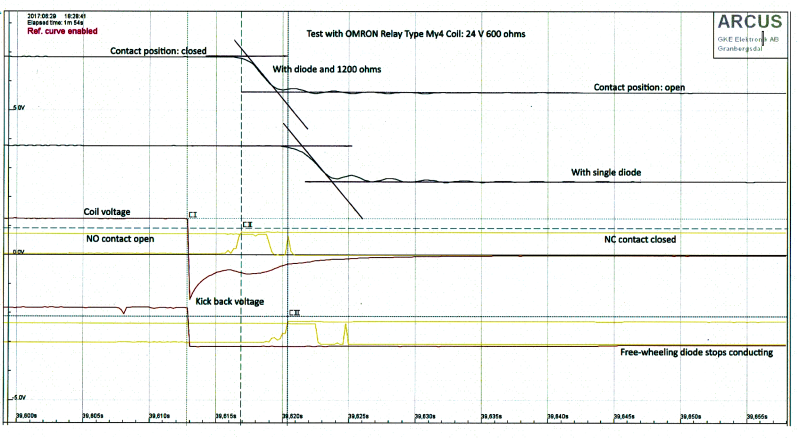

Anyhow, I have been young and inexperienced myself. So I know how one can get a fixed idea in one's head and that such ideas can grow into real hinders. I therefore did a few tests with an OMRON 24 V DC relay (sorry, no 12 V). The comments in the recording should be clear enough. But I add some of them below:
1. The test shows coil voltage (brown traces) with a diode and also with a diode plus a 1200 ohms resistor (twice coil resistance)
2. The black traces are contact position. The movement is around 1 mm. A little less, actually.
3. The orange and yellow traces show NO and NC contacts and how they conduct.
4. The release speed is totally independent on if you use a single diode, diode plus resistors, zener, RC or MOV.
5. All that changes is delay. And that is of no concern in this application, if I understood you correctly.
I would normally bill you $150,000 (like IR), but I didn't use that much time on this. So 15 kUSD is OK with me. Where shall I send the bill?
