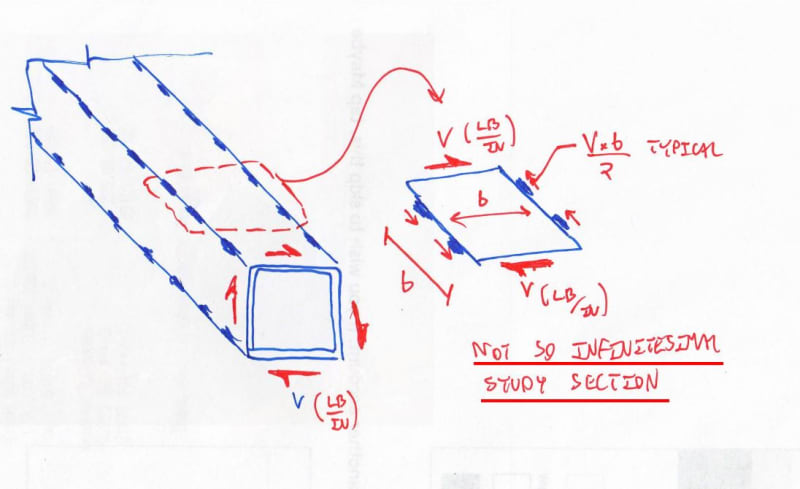

Meh. I absolutely agree that it changes the character of the shear field such that other things are going on but I'm not sure that I see bending as the predominant thing. It would be more tension/compression field under any reasonable weld spacing I think. See the sketch that I'll post in the comment after this one.

I vigorously disagree with both of these statements. The sketch below illustrates the mechanics of where the shear would go in the stitch welding case. There are places for the load to go when you cut out a chunk of side as well, those places are just flexible to a neutering degree.

A stitch welded cover plate does have similar discontinuities. They are the stitch welds and the fact that, as I mentioned in the previous post, the stitch weld make it such that shear cannot be added to the beam in a Bernoulli sense between stitch welds.

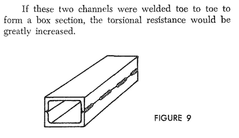

Would you be willing to put more stock in Omer Blodgett's assement?
Just to clarify, I think a stitch weld is likely completely reasonable within the normal limits of element width to thickness ratios and stitch spacings that a reasonable engineer would pick for something like this. There is just definitely a bending/buckling/compression failure (depending on whether you want a bending or truss analogy between the welds) limit state in there that one has to keep in mind. The folded card example demonstrates an extreme, but I think is valid in demonstrating the overall effects that you'd see. Note that if you make very small perforations, you would end up with a pretty stiff and stable structure as well. It's not something I'm overly worried about, but there's some limit there and I'm curious about the limit state.
I'm pretty sure I could draw up a pretty good truss analogy that I could use to verify design if I really needed to. I'm also confident that stiffness is affected, but the extent of that effect depends on the spacing of welds and properties of the plates. For reasonable stitch distances it might be small enough to ignore, but if you're really deflection sensitive on something it could add up over a distance.
Note that you can totally build up a box section using nails, rivets or bolts that has increased torsional strength. You can also make a space frame truss box section that has increased torsional properties. You don't need that continuous connection.
Also of note for people saying it's absolutely necessary, Blodgett specifies a stitch weld on a closed box section used for torsional resistance on page 2.10-24 of 'Design of Welded Structures'

I let that post sit too long obviously, but my Blodgett reference was more explicit!
Nice. I scanned through that but didn't catch that he switched from continuous welds to intermittent at the last.
