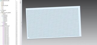

my private investigation proofs one thing - if Turbo Pattern is considered ==> copy geometry, not features!
with this approach(Copy Geometry not Features), it realy does not cate where/how you create rounds(internal/external), because at the end you should copy final quilt, not features which build it.
I have nice comparison. I created simple example - rectangle plate and geometry to cut which consists originaly of 10 feats:
a) I made a Pattern(38x23) of 9600 instances(because I selected whole group) and it tooks 13 min, not to mention next ref pattern to Solidify > Remove material
b) I copied only quilt of merged features and then I made a pattern of it (ca. 900 instances) it tooks 1 minute and extra one to remove material
What I had done in addition:
1)I decided to separate pattern of instances from original model, because itself(the model) it can be enough complicated regarding the time of regenaration
2) Copy geom of base surf to extra model
3) making Tubo pattern(copy geometry not features)
4) Copy geom of patterned geom back to native part and Solidify remove or Cut out by Component
Above has unfortunately many disadvantages:
* it is complicated
*it is time consuming
*it creates circural references. This however can be avoided by removing the patternded goem not in native part, but in the extra one made by Copied geoemtry from the nativer model
you can also save patterned geometry as STEP file, load it and use to cut out - funny, strange, but it could help to avoid pushing Pro/E to regen everything too long:)

just to mention, by default, I do not mean to use Copy Geometry tool when wrtiting: copy geometry not features
There is an example I made for this particular issue. check how I manage the patterned geometry: I copy quilt not group of parrent features, which at the end gives me a lot of time savings regarding Pattern regenaration
https://docs.google.com/file/d/0B60eG4B19bE4Zk5wOGNlZ0VjZlU/edit?usp=sharing

I see what you're getting at, now. You extruded as a surface, merged/intersected the surfaces, copied and patterned, then solidified. I will have to try that. Thanks a lot!
FWIW, my idea to do a cosmetic did not pan out. I still had to pattern in one way or another, and it still took a long time to regenerate.

Ok, I tried your idea, Jacek, but for some reason, Merge is grayed out in sheetmetal. I had such high hopes. I also tried to extrude the surface, pattern that, and solidify, but although it works to do it that way, it is taking a long time to regenerate the extruded surface pattern, too. I guess that makes sense, if I think about it.

An update: I got the pattern to regenerate successfully. I just had to be patient. Luckily, I had at my disposal an extra machine and license and just let the thing run until it was done. I ended up having to shut down practically everything else, including automatic updates, to prevent the machine from rebooting mid-regen, but I got it, and then was able to mirror the pattern (another long wait) and create a DXF, which was what we were after. The as-designed part (designed by someone else in a different CAD program) was not fully featured in that program, and so the as-built parts did not match the as-designed parts. Now, we have a DXF to give to the vendor so that hopefully we can get parts that match the design intent.
Thanks for everyone's input, and while it didn't directly affect this problem, I did learn a good amount of stuff along the way.
For what it's worth, although I didn't keep an exact tally, I believe the final time investment was somewhere between 48 and 96 hours. It takes roughly a day and a half for an assembly containing two of that part and two other high-feature-count parts (but considerably fewer features than this part) to open.
