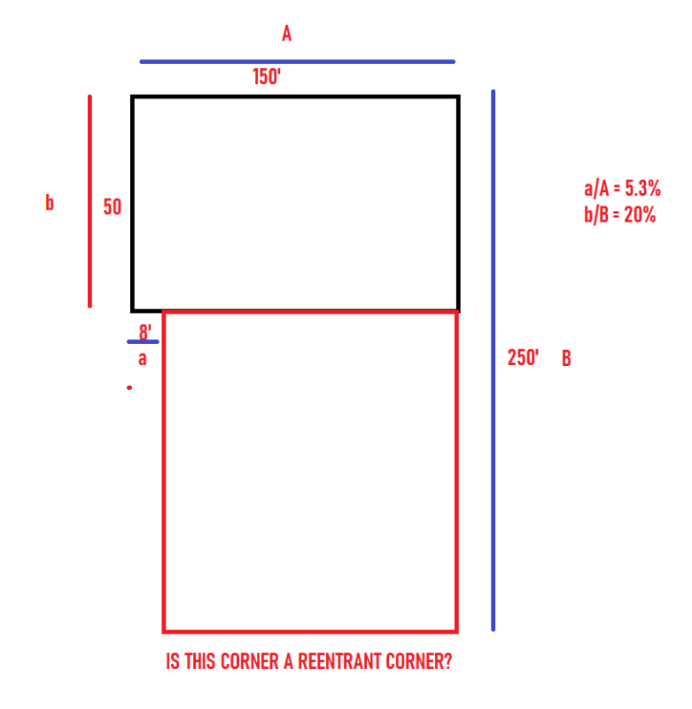

Dear Engineers,
I hope you all are fine.

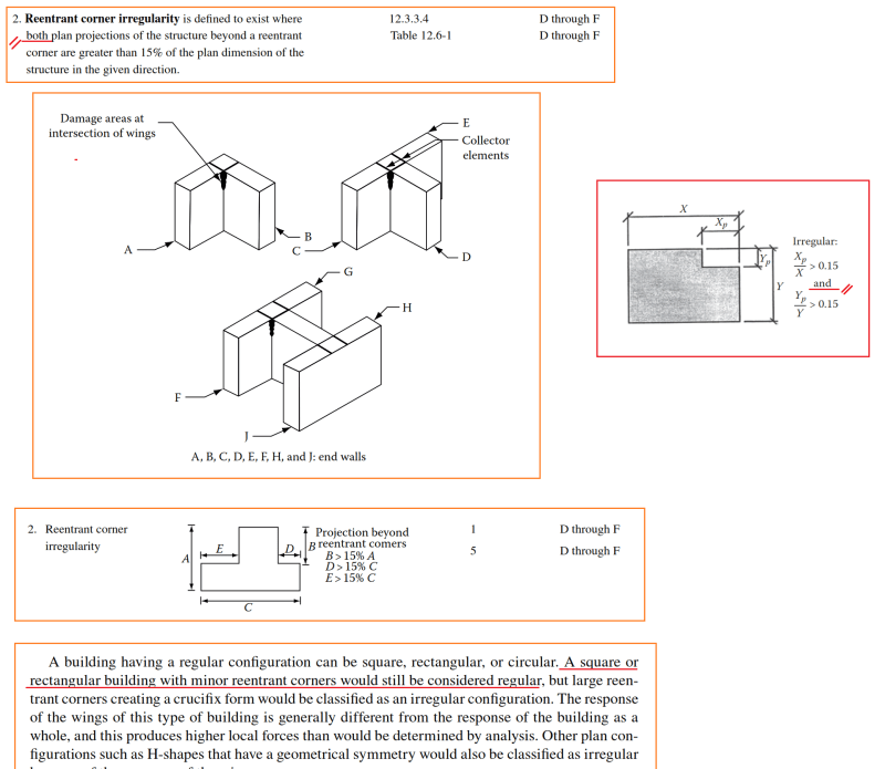

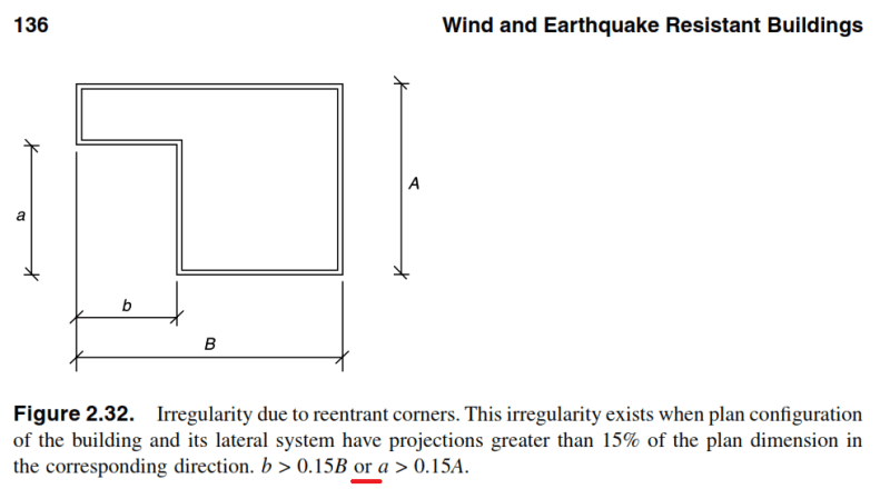

Please refer to the following figure.
I have read the following and compiled some texts from the books of Taranath.
Again elsewhere I found this, where it says "or" (either of them, i understood)
What ticks in my mind is, both the projections need to be greater than 15% of the correspponding plan dimensions, otherwise it won't form a cruciform large enough to concentrate stress. But I couldn't come to a conclusion on this.
Please share your understanding of the matter.
