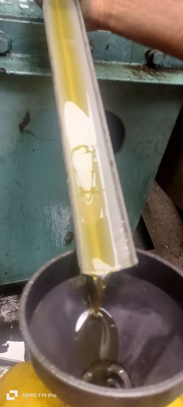

"despite satisfactory oil level and condition. "
How is satisfactory oil level determined ?
If oil condition means oil analysis, oil analysis would have to be done very frequently to catch the beginning of this problem.
Like maybe every day.

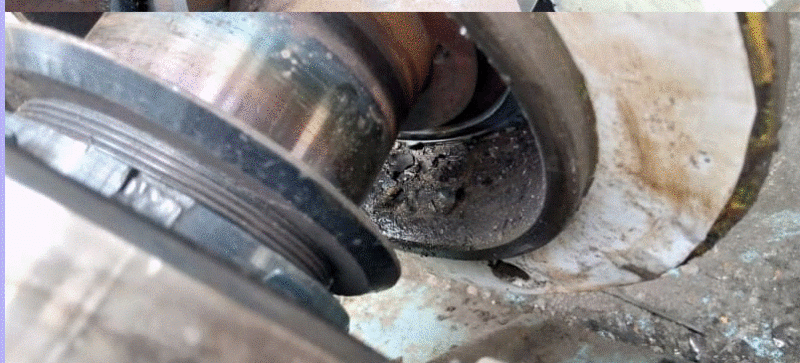

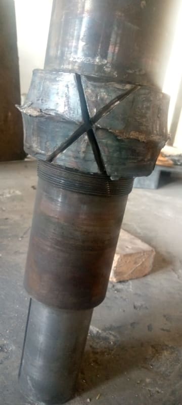

Looks like the inner race cylindrical bores are clamp against shaft shoulders.
Axial expansion must be considered, and allowed. In simpler systems one bearing's outer race would be axially "fixed" and the other would have axial clearance between the outer race faces and the housing shoulders or cover pilot. The large housing that has both outer bearing seats and the cover pilots need features controlled to provide proper axial location and allow thermal expansion.
The lower housing half appears to have a shoulder on the inboard edge of the failed (drive end) bearing.
I agree there may be indication of overheating of the shaft near the bearing, and that seems important to understand. But there seems to be an absence of brown varnish or other evidence of associated widespread overheating in the bearing itself (at least the parts we can see). I have a hard time reconciling those things. Do others have comments / ideas on that?

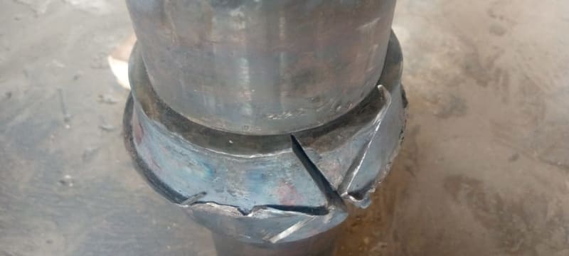

...The one thing it brings to my mind is maybe the bearing inner ring spun on the shaft. We can see locknut with lockwasher engaged but that's not a guarantee bearing didn't spin on the shaft. Maybe further disassembly photos and any available fit measurements will shed light.

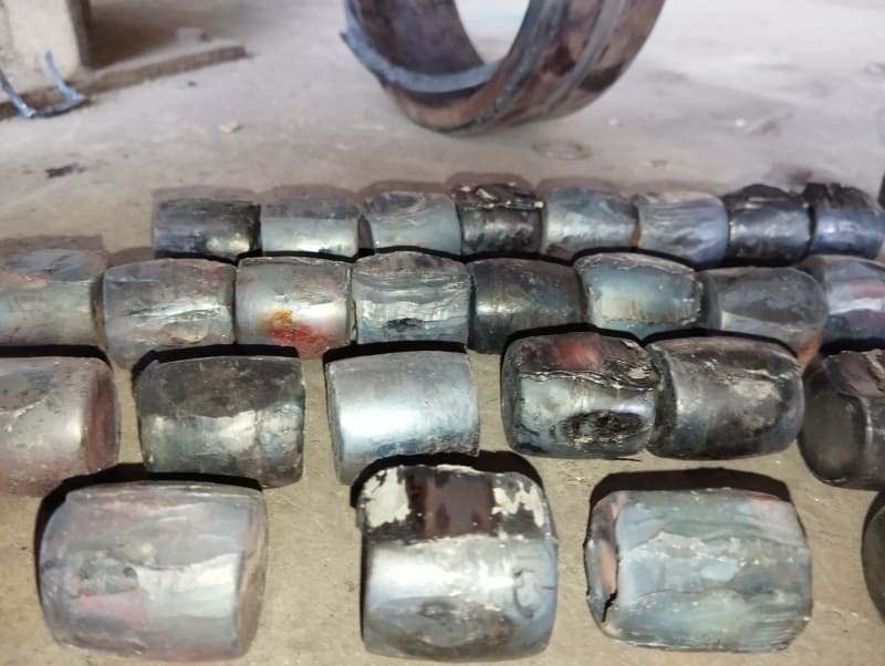

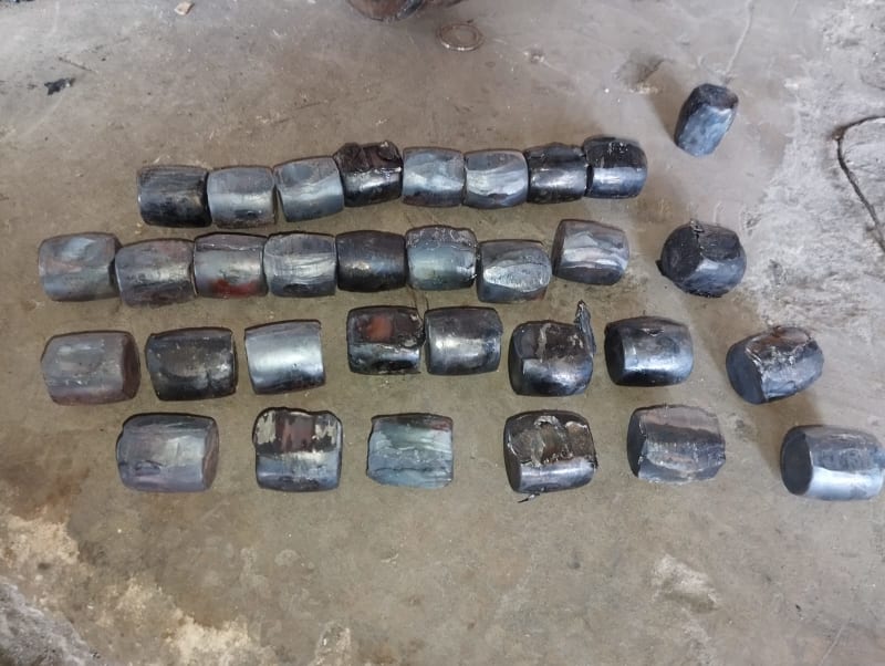

Once the cage fails all of the rollers bunch up and stop rotating. The inner race may have spun in the stationry rollers causing it to heat up. You can see the flat spots on the rollers in pic#9.

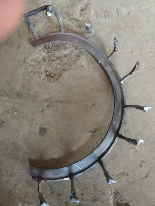

There are a few cage material options. Consider if the cage was of the correct material? Stamped steel and machined brass are the most common. I have never had to specify a cage so I can't explain the differences.

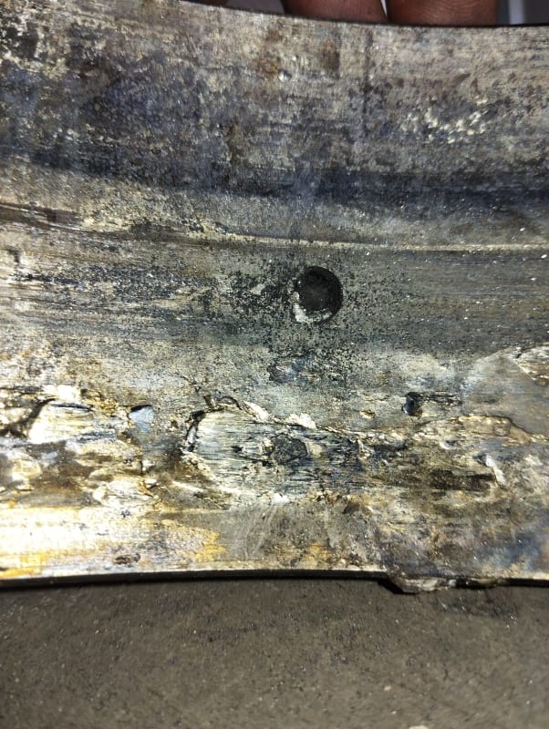

I took some new pictures after cutting the bearing. I saw some interesting findings.
These pictures shows like there is some surface fatigue or spalling. Please look and share your thoughts on this.
In above picture, this circular groove or indentation mark on upper race confusing me.
Please look these rollers picture, There is indentation mark on almost same area of rollers. May be this is an indication of some extra load or unbalance load. Share your experience.

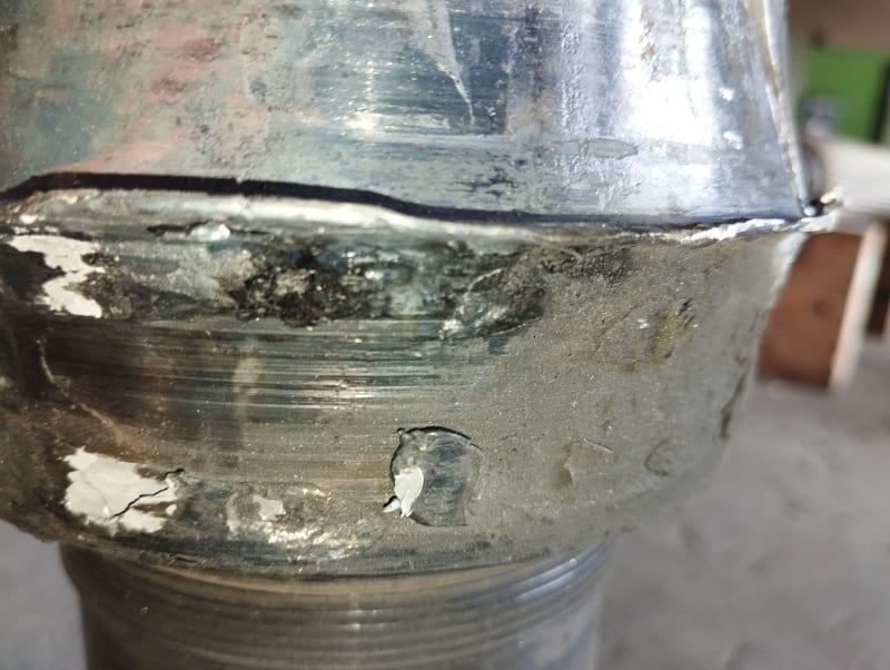

I am attaching some more pictures for your better understanding.
I think in this case, there is a possibility of surface fatigue which accelerated due to low oil level. Total oil capacity is 20 liters but the oil we took from bearing block was 17.5 liters but oil color was satisfactory.

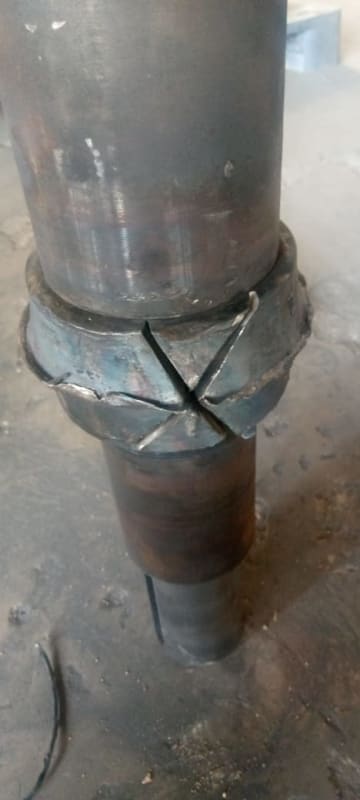

Also please look below picture of inner race. We tried a lot but it is stuck with shaft. Due to unavailability of proper tools, we decided to cut it.
I believe those final pictures show cage, roller, race and shaft damage typical of a catastrophically failed bearing.
Like the honorable EPete said, "there's lots of damage, so what came first".

Next time you need to remove a bearing race, stand the shaft on end so it is vertical and take your largest torch and heat the race RAPIDLY until it falls by gravity.

Yes, 17.5 liters of oil being drained from the housing.

No oil Change activity since last 10 months.
