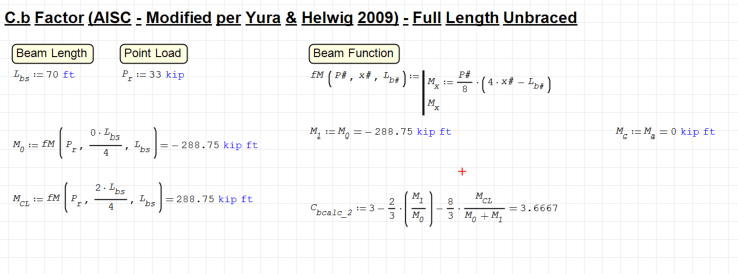

2.) Try to back calculate C.b using Mastan2. If I use the modified C.b factor I get 3.667. That means that the nominal capacity would be 393 kip*ft or 532.2 kNm. This is higher than the elastic buckling we found with mastan2. So let's scrutinize both.

The modified equation seems to be specific to a uniform load not a point load. Maybe this is giving the error. Maybe we try to model a uniform load in Mastan2?
Hand equation: 107 kip*ft x 3.667 = 392.6 kip*ft

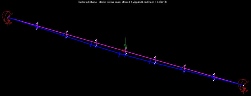

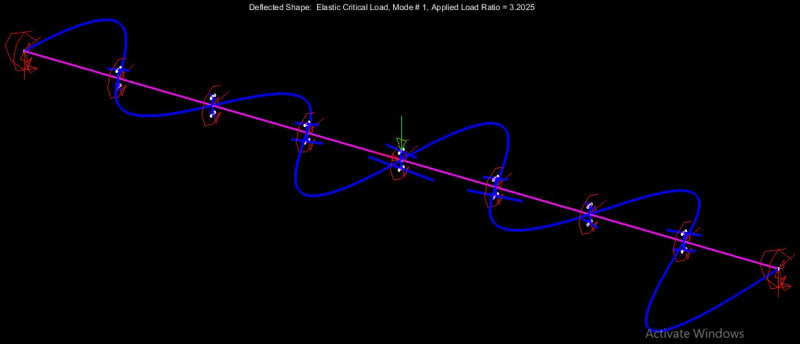

W10x12 coming up then, all braced up. I"ll put my money on it going past plastic section capacity.
Can you compare to the L case too, for that particular beam...
W10x12
Mid-span point load = 12 kip (full section yield at 11.7k)
Span = 36'
File: Link

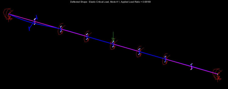

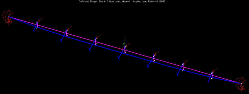

Run #1: ALR = 0.19055; L-braces everywhere.
Run #2: ALR = 0.68169; F-braces only at locations consistent with AS4100.
Run #3: ALR = 3.2025;F -braces everywhere.
What’s the unrestrained capacity of that beam?
Not much it seems. ALR = 0.069133. Unadjusted, elastic LTB "capaccity" as usual.
As I described in my response to RFreund, the cross sections represent nothing at all in terms of reality. Just visual aids and a way to apply restraints and loads to locations other than the beam centroid. That said, they do draw a little load and, therefore, do deform a bit. For some of these buckling modes the deformation is incredibly small. So small that they are on par with the tiny cross section deformations which is why you see the stretching that you commented on. The reality is that these cross sectional deformations are present in all of the Mastan runs, they're just imperceptible relative to the other, much larger deformations in many cases. For comparison, in that last diagram in the bunch of three above, you're looking at a flange tip elongation measured in 10^-13 inches.
This is my best guess at least. It's difficult to parse out some of these effects.
I can only see two possibilities, unfortunately.
1. These buckling results are all wrong.
2. AS4100 simplified segment method can be unconservative when L restraints are used.
We could be missing something, but no ones coming up with much....
