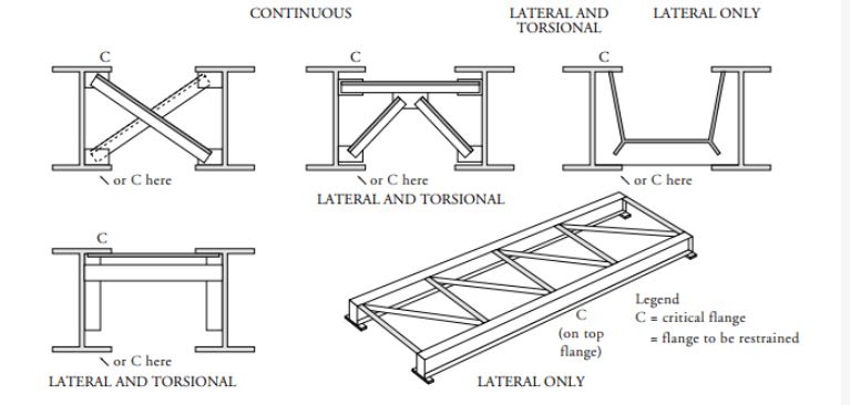

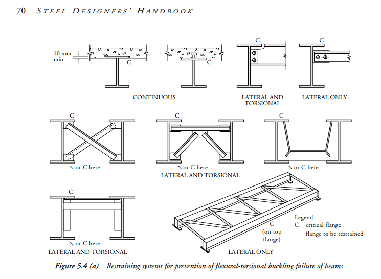

And one more thing. Going back to rotational restrains being used for mulitple adjacent beams. It seems that plenty of Australians may be doing it wrong, that includes myself:
4.1.5: "Cross-sections that are not effectively prevented from deflecting laterally are treated as unrestrained in AS4100, no matter how effective the restraint against twisting may be", then suggesting that design by lateral buckling can be used if this is considered too conservative.
This contradicts what I posted earlier which is from one of the more prominent texts of AS4100.

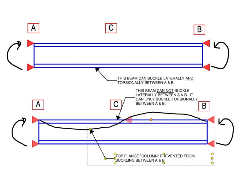

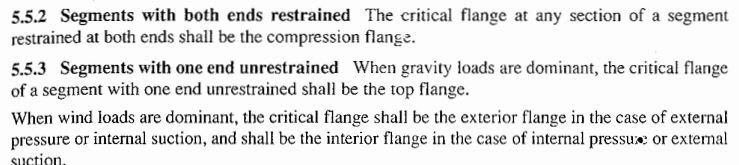

[highlight #FCE94F]KOOTK'S ALL ENCOMPASSING THEORY OF AS4100 LTB[/highlight]
For the sake of readability, I'm going to present everything that follows as fact even though it is really just my opinion. Just imagine all statements preceded by an "in my opinion".
When Steveh49 provided me with the revelation that AS4100 is treating L-restraints as Faux-F-Restraints, that gave me the missing puzzle piece that I needed really pull together a cohesive theory that I've been ruminating on for a few weeks.
A) WHAT THE THEORY WILL EXPLAIN
A1) Why we see the apparent discrepancy between the "compression flange" and "flange that moves furthest" definitions of the critical flange.
A2) Why, in the context of the AS4100 LTB method, a brace point must restrain lateral translation and cannot simply restrain rotation (roll beam concept considered valid in AISC methodology).
A3) Why, in the context of the AS4100 LTB method, the tension flange must not be treated as though it provides effective LTB bracing even if, in many real world situations, it may indeed provide effective LTB bracing.
B) WHY MY ANTIPODEAN FRENEMIES SHOULD LOVE THIS THEORY
B1) The theory explains all of the stuff listed above as a coherent, inter-related story. The truth tends to do this.
B2) The theory results in pretty much the most literal read of AS4100 possible. I know that it gets your guys' blood up when I try to reinterpret your codes. I would only alter 5.5.2 like this to avoid the confusion that we've seen in this thread:
AS4100 Modified said:
5.5.2 Segments with both ends restrained. The critical flange at any section of a segment restrained at both ends shall be the compression flange regardless of whether or not the compression flange would deflect the farther during buckling in the absence of restraint.
C) BACKGROUND

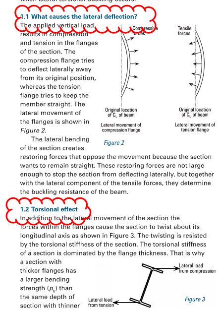

I've been debating LTB with folks on Eng-Tips for years now. And I always describe the phenomenon using the pedantic phrase twist about a point in space located at, directly above, or directly below she shear center. I describe it like that because I feel that's the most precise description and the only one that keeps you out of trouble at free cantilevers and the like.
Invariably, somebody chimes in with "I disagree, LTB is really caused by the compression flange acting like a column and trying to buckle laterally while the tension flange attempts to straighten itself out". This is the argument shown below. I defend my position vigorously but, really, I sympathize. Most of the time, I think that compression flange buckling really is the bulk of the LTB story and that LTB can pretty accurately be envisioned as the superposition of two separate effects:
C1) The [L] in LTB. A nearly pure lateral sway about a point of rotation in space above or below the shear center.
C2) The [T] in LTB. A nearly pure torsional roll over about the shear center or a point close to it.
Different situations have different proportions of [L] relative to [T]. For a free cantilever, for example, the center or rotation is somewhere down in the earth's mantle and [L] dominates. In this case, the flange that is furthest from the center of LTB rotation, and would deflect the most, is the most efficient to brace. That flange may or may not be in compression as the free cantilever example demonstrates.
For any beam constrained to buckle about a point of rotation at or between its flanges, however, [T] will tend to dominate. In this case, the story of LTB that is "the compression flange buckles as a column" is pretty near to being the complete truth. As such, in this instance, the best (and really only) way to eliminate this source of instability is to brace that column (compression flange).
D) THE THEORY
AS4100 said:
5.5.2 Segments with both ends restrained. The critical flange at any section of a segment restrained at both ends shall be the compression flange.
So what's special about an end restrained beam segment that allows it to be put into this convenient bucket where the compression flange is always the critical flange? I contend that the special feature of such a beam is that, once a meaningful, lateral brace is added along its length, it becomes a member in which twist ([T]/C2) dominates and lateral sway ([L]/C1) is effectively off of the table without further designer attention. And this is why braces must prevent lateral movement and not just twist for the AS4100 method (A2). A brace can't be imagined to rule out the lateral component of LTB if it doesn't, you know, restrain the lateral component.
Once the source of instability associated with lateral sway ([L]/C1) has been stripped away by the lateral brace, the only remaining source of instability is that associated with pure-ish twist ([T]/C2). And since that is instigated by something resembling pure "column buckling", the only rational way to deal with that is to laterally brace the compression flange. This is why tension flange bracing is deemed useless when applying this portion of AS4100 (A3). Tension flange bracing would improve twist ([T]/C2) resistance but it wouldn't come close to eliminating it because the compression flange could still "column buckle" and force rotation about the axis of the tension flange.
E) THE CONCLUSION
5.5.2 Should be read literally, as the compression flange being the critical no matter what (A1). It isn't actually the case that 5.5.2 is a subset of 5.1.1. They are separate and one need not imply the other as shown below.
Yes we discussed this previously. Most of us seemed to agree that 5.5.2 is separate (though overlapping) with 5.5.1.
In my opinion it's still very murky.
L restraints only laterally restrain the point they're attached to. They don't laterally restrain the entire cross section. As it rolls the entire cross section except the point of support continue to move laterally.

But what about the bottom flange moving laterally?
I don't draw the distinction between torsion and lateral movement you do. It's a global translation. I don't think it's right to say the beam isn't moving laterally and is merely twisting. When the top flange is pinned and the beam rolls the beam centroid still translates and rotates. Certainly it rotates a lot less than with no lateral restraint, but it's still not pure rotation/torsion.
If you're not willing to entertain thinking in those terms then, truly, my theory is not for you as it's very much predicated upon that. However, as shown below, I am far from the first to think of LTB in terms of largely separated twist and lateral sway components. And I contend that the writers of AS4100 may have been thinking in this way too.
The bottom flange moving laterally only contributes to the instability associated with the lateral sway of the cross section. For the component of instability associated with twist alone, the bottom flange is actually improving the stability of the situation. As such, once the lateral motion is removed from the system by a new brace, so is the instability associated with tension flange lateral movement.
You'll notice in my work that I took care to always describe it in terms like nearly pure rotation rather than just pure rotation. My supposition is that there's a world of difference between LTB where the center of rotation is in the earths mantle and LTB where the center of rotation is within the depth of the cross section.

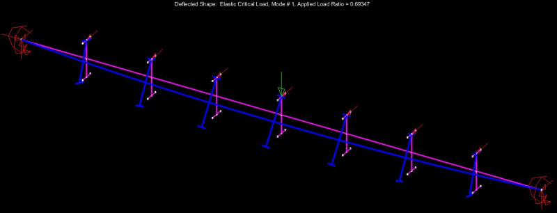

I actually only ran that because steveh49 asked for it. That said, that one would be pretty close to the "put it to bed" number. I'd been meaning to do that exercise anyhow so here it is, cleaned up with the full set of braces and no accounting for imperfections.
Mp = 1016 k-ft = AISC plastic = AS4100 plastic
Mn = 589 k-ft = AISC LTB number done the usual way assuming a member with no intermediate restraint.
Mb = 1171 k-ft = AS4100 LTB number assuming a segment length of 8'. This exceeds Mp of course.
Mastan = 690 k-ft = 250k x L/8 x ALR = 250k x L/8 x 0.69.
So you're getting a 17% bump by going from regular AISC LTB to constrained axis AISC LTB. This actually seems pretty modest considering you're going from no intermediate restraint to, basically, a continuously braced top flange.
Mastan elastic critical buckling, sans imperfections comes in at 50% AS4100 LTB. Shutout to Celt's spreadsheet for running the AS4100 for me. It takes a village.
Mastan file can be found here for review & tinkering: Link

For this example, see the plot below and this Mastan file: Link. Quick notes:
- Span = 70 ft = 21.3m
- Sub-segment length = 7 ft = 2.13m (10th points. Probably doesn't matter much as long as it's close enough to force the constrained axis buckling mode.
- Elastic critical analysis.
- No imperfections modeled so a high side estimate.
- Fy inflated to ensure an elastic buckling failure mode.
- No weak axis rotational restraint at the ends.
- Applied Load Ratio = 0.1026
- Fails at 0.1026 x 250k = 26k point load
- Fails at 2768 kip*in end moment = 313 kN*m (25% of your phi.Ms. value of 1240 kNm)
CONCLUSION: if I've not screwed anything up, I believe that this would suggest that the beam length at which constrained axis LTB would occur can be expected to be significantly shorter than the value at which AS4100 would predict that LTB would govern over phi.Ms.
When I check your file to see what everyone is going on about regarding the apparent unconservatism (because I haven't really been following along with tht line of the conversation), I note the model doesn't have warping set to continuous. So results are not quite valid as you get a reasonable benefit from this.
But I am seeing the same differences in capacity, in my checks on the 70 ft case with L restraints only in the 5/8, 4/8, 5/8 span locations as per code requirement for consideration. The end span is critical. The difference from the hand check over 8001mm segment gives ~phiMbx = 682kNm. But the capacity from a buckling analysis method is coming out at phiMbx = 269kNm. This is just using table 5.6.1 case 1 for calculating alpha_m (have not calculated alpha_m using 5.6.4(b) method to see if that would be different).
