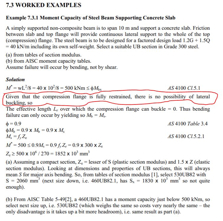

HS_PA_EIT said:
Here is a worked example from "Steel Structures Design Manual To AS 4100" First Edition by Brian Kirke, Senior Lecturer in Civil Engineering Griffith University and Iyad Hassan Al-Jamel, Managing Director ADG Engineers Jordan.
Thanks for the example. It's definitely more cut and dry with simple span beams and continuous compression flange bracing. I'm fairly certain that all codes give you a pass on LTB in that situation. That said, I agree with your base point that I would reiterate in my own words as follows:

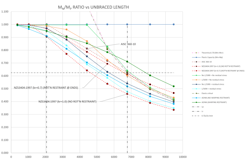

What are the major differences to AISC? It looks to me that, aside from L restraints on segments with moment reversal, they're pretty similar. Our L_e calculation may have a bit more to it. Is there more?
I'm at the point of wondering whether L restraints with moment reversal are something not handled well by AS4100. Perhaps the rule was derived from considering simply-supported beams but applied generally. See graph at the end.

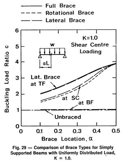

Would you say that the lateral brace at [2] makes this truss immune to LTB?
I don't like the look of node 4. That aside, K_l=1.0 doesn't mean immune from LTB, it means no more exposed to LTB than for shear centre loading. But I now agree that top flange loading at a top flange L restraint should use K_l>1.0 if the bottom flange is going to move sideways.
Tomfh said:
When do people use P restraints? I can’t recall ever bothering with them.
They might be free or geometrically preferable to F restraint whilst almost doing the same job. I've attached some guidance on what is F/P from an article in the Australian Steel Institute Journal from 1993 (by Trahair, Hogan & Syam).

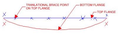

Bottom flange L restraint in a simply supported beam under gravity loading does nothing for capacity. I can't find much else regarding tests or analysis of L restraints, which is why I wonder whether simply-supported results were just extrapolated to applying universally. The graph below shows results of elastic buckling analysis. Note also Agent666's case #1 rotated about the bottom flange anyway so bottom flange restraints wouldn't be stressed.

A) I'm not sure it is just one mode. We have to check all segments but often it's obvious which will govern. I think in the W27x84 case they represent different modes as different flanges are critical.
B) The effective length combined with the alpha_m factor is meant to relate to the capacity of a beam under uniform moment. I can imagine that the length would get a bit abstract when the moment is nothing like uniform.

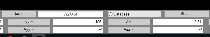

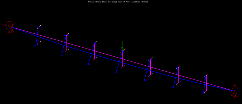

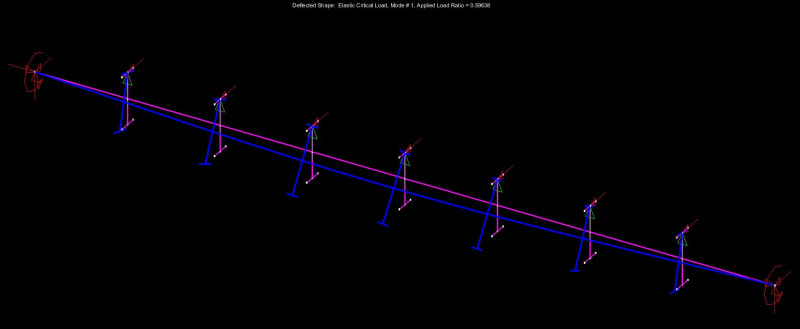

For your 32 ft example, see the plot below and this Mastan file: Link. Quick notes:
- Elastic critical analysis.
- No imperfections modeled so a high side estimate.
- Fy inflated to ensure an elastic buckling failure mode.
- No weak axis rotational restraint at the ends.
- Applied Load Ration = 0.59
- Fails at 0.59 x 250k = 147k
- Clearly a version of the constrained axis buckling mode that I've been droning on about.

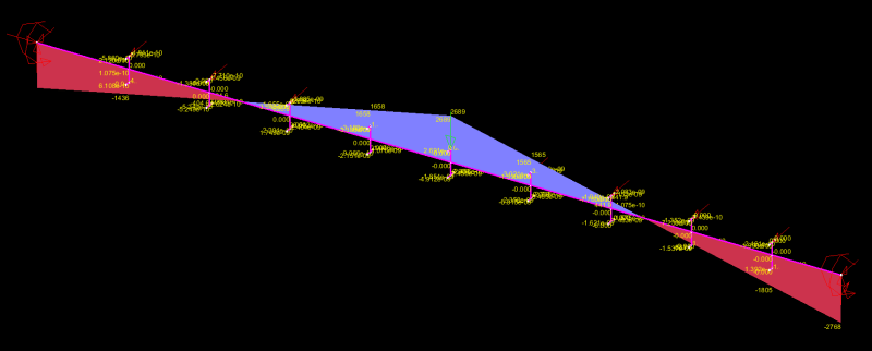

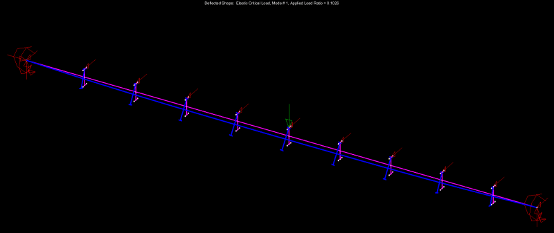

So the exact numbers here have been drifting a bit. And, because of the way that Mastan is sort of unit-less and has canned AISC sections in inches, it's much easier for me to work with spans and segment lengths that are in even increments of inches. So I tweaked your numbers a bit but, I suspect, the analysis will still serve the purpose that you'd intended.
For this example, see the plot below and this Mastan file: Link. Quick notes:
- Span = 70 ft = 21.3m
- Sub-segment length = 7 ft = 2.13m (10th points. Probably doesn't matter much as long as it's close enough to force the constrained axis buckling mode.
- Applied Load Ratio = 0.1026
- Fails at 0.1026 x 250k = 26k point load
- Fails at 2768 kip*in end moment = 313 kN*m (25% of your phi.Ms. value of 1240 kNm)
CONCLUSION: if I've not screwed anything up, I believe that this would suggest that the beam length at which constrained axis LTB would occur can be expected to be significantly shorter than the value at which AS4100 would predict that LTB would govern over phi.Ms.
SURPRISE OBSERVATION: the moments at the ends are different from the moments in the middle. I should have anticipated this, in retrospect, but did not.

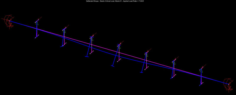

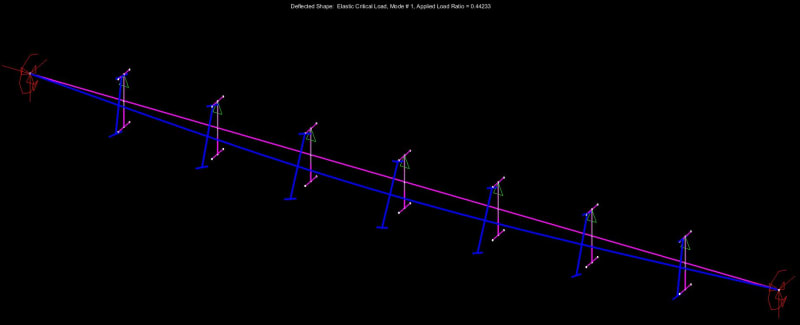

With Mastan set up on my virtual machine, it seemed easy enough to just test this and put it to bed.
All cases: W27x84; 32ft; 35 kip uplift loads at 1/8th points; total load = 245 kip; elastic critical run; no week axis rotational restraint at ends.
Case 1: simple span beam with no L-restraints. ALR = 0.44233; Total Load = 109 kip
Case 2: simple span beam with L-restraints. ALR = 0.59638; Total Load = 146 kip
Case 3: fixed end beam with no L-restraints. ALR = 2.882; Total Load = 706 kip
Case 4: fixed end beam with L-restraints. ALR = 7.001; Total Load = 1715 kip
CONCLUSIONS:
A) For the simple span case where the bottom flange is everywhere in compression, the improvement was not as much as I'd hoped at only about 34%. Looking at the deflected shapes, it seems that this is because the unrestrained center of LTB rotation is pretty much at the roof deck level anyhow so not much changes by adding the deck.
b) Once end moments are introduced, the improvements come fast and a constrained axis LTB failure seems improbable. This jives with the AS4100 method which would have counted several of the top flange restraints as L-bracing at the ends of the beam. And I think that I might see why now. Once your get both flanges trying to do some buckling, the LTB mode becomes skewed more towards the lateral than the torsional. This pushes the center of LTB rotation up further above the top flange and makes the the L-restraints that much more effective.

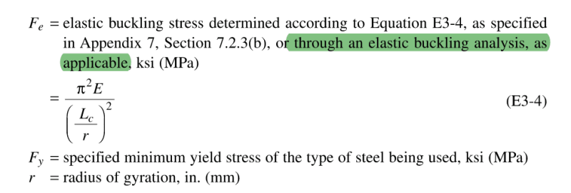

Not quite, in AISC I believe you replace F_e the elastic buckling stress, then evaluate F_critical normally from there! It's basically the same in AU/NZ standards, instead of working in stress which is fairly meaningless, we work in moment. Elastic buckling moment is equivalent to elastic buckling stress, Fcrit is equivalent to member moment capacity M_bx.
So in AISC there is a codified way of taking account of any restraint condition imaginable, backing up the assertion that any restraint to the compression flange can in fact be used as essentially AU/NZ standards have the exact same provisions, a buckling analysis quantifies the effect. I linked to an article earlier that suggested AISC doesn't account for initial imperfections so there are some differences in the underlying stuff though.
So in conclusion you can do a buckling analysis to work out the elastic buckling stress, clause E3 states this explicitly (see below). Once you have this from a buckling analysis then you carry on as per normal design.
So keeping this in mind, if you're ignoring any intermediate restraints that a buckling analysis might show are effective you're potentially being very conservative (obviously every scenario is different), even if that's the way the examples and hand checks show to AISC.

But as I noted, it's not of importance if you are doing the code implied eigenvalue analysis, by this I mean get buckling moment, apply normal code reduction, get equivalent capacity.
If you go through the mastan2 stability fun modules, it takes you through each type of analysis and compares answers. The upshot is if you allow for all the second order effects and use the 2nd order elastic or inelastic analysis you'll get pretty close the code curve which indirectly allows for these things (these analyses are more your full on FEM type of thing that gives you the capacity directly because you've allowed for the 2nd order stuff and don't need to apply the code curve reductions (i.e. alpha_s in AS4100/NZS3404 terms).
Screenshot below of my attempt at this when I went through it a year or two ago with both AISC and NZS3404 results. Shows the importance of allowing for warping and imperfections. Note where the default AISC curve sits relative to the L/1000+ warpingresidual stress curve relative to the NZS3404 kr=1.0 curve. The Adina FEM results were provided by the author for comparison, you work out all the rest as part of the stability fun exercise if you want to go down that rabbithole! (I highly recommend it if you have hours to spare, and I mean hours (per module)....).
direct link to full size picture
Thanks for that. Most of those P connections I never use, but good to know.
Interesting that they count a fly brace on unlapped purlins as P. “Design of Portal Frames” says to not bother and take kt=1.0 at fly bracing.
It needn’t just be simply supported cases. As noted by others above, for gravity loads the top flange is often the best place to buckle, period, even in continuous beams when the top flange has gone into tension. That is to say the top flange will often buckle the furthest, even in tension zone. Bracing it boosts buckling capacity more than the bottom compression flange, contrary to the “compression flange is critical” rule. (Vice versa for wind uplift). From memory the old code AS1250 reflected this. It specified critical flange for gravity as top flange, and bottom flange for wind.
Then they changed the simplified rule to “compression flange is critical”, which emphasises moment reversal - even through moment reversal isn’t actually that relevant to LTB - (buckling shapes do not mirror bending moment diagrams)
The current rule covers cases where bottom flange compression is really important (say a deep haunch), and still probably good enough even when the tension flange is the real critical flange - which is a lot of the time.
Yes, you’re grabbing it in a place it doesn’t move much, so grabbing it there doesnt do much.
This is what we were saying before, hence AS4100 saying no restraint for you if you grab it there.

It’s obvious why laterally bracing a non critical flange (ie laterally bracing close to the centre of rotation) is generally considered ineffective. Because the beam can still fall over. You’re adding your pin at the pivot point, where it does far less. That’s exactly what happens in these situations. The beam can just flop over, pivoting about the restraint.
When you brace the part that wants to move (aka the critical flange) you inhibit that rotation from occurring at that section.
