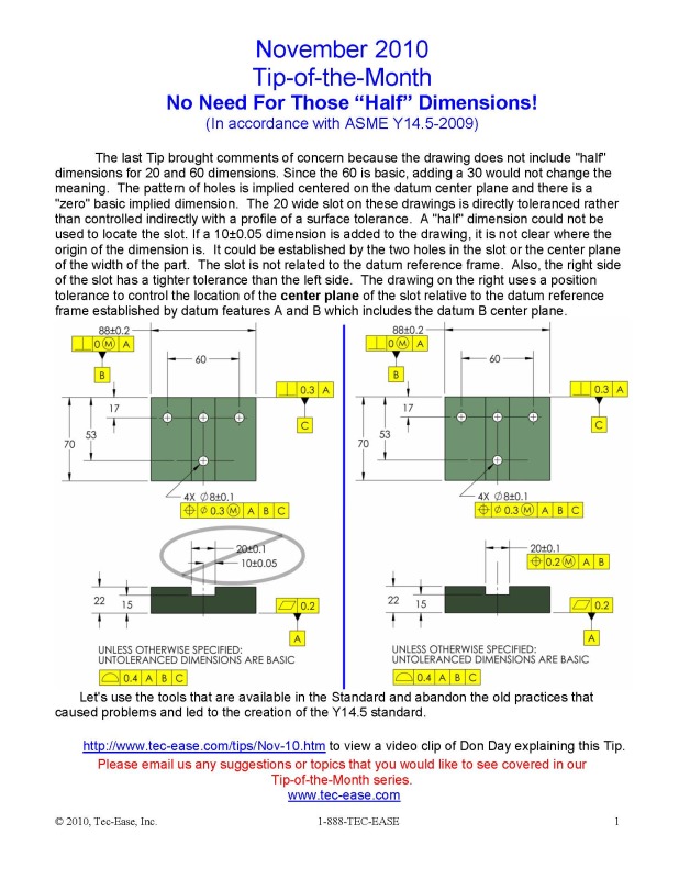

What fundamental rules suggest that ‘half” dimensions are implied, as specified in the attached document?
Might be multiple rules combined and I would like to know them.
Not disagreeing, but I would like to get the details.
gabimot,
The drawing looks symmetric, and there is a centre-line implying symmetry. Also, note how the secondary datum is a feature of size. It defines the centre. This is the only possible interpretation of the drawing.

Just to resolve my “work argument” what are the written ASME Y14.5 rules to reflect what you just said (symmetry)?
Thank you for your help
Fundamental rule 1.4(k) in Y14.5-2009. Is this what you are looking for?

I don't think you need something else (besides proper understanding of the rule, which in reality quite often is not well understood).
Do you have any specific scenario in which you feel this "implied basic zero dimension" rule does not fully work for you?
10+/-0.05 is not the only "half" dimension missing from the drawing.
I have nothing against FOS missing a half dimension. In fact, that's the only way to do it.
But locating dimension is different from size dimension. Implied zero is the real thing, while the implied symmetry is not.

Fundamental rule 1.4(k) in Y14.5-2009 does not state anything about symmetry.
(j) A 90° basic angle applies where center lines of features in a pattern or surfaces shown at right angles on a 2D orthographic drawing are located or defined by basic dimensions and no angle is specified. See para. 2.1.1.4.​
(k) A zero basic dimension applies where axes, center planes, or surfaces are shown coincident on a drawing, and geometric tolerances establish the relationship among the features. See para. 2.1.1.4.​
2.1.1.4 Implied 90° or 0° Basic Angle. Where center lines and surfaces are depicted on 2D orthographic engineering drawings intersecting at right angles or parallel to each other and basic dimensions or geometric tolerances have been specified, implied 90° or 0° basic angles are understood to apply. The tolerance on the feature associated with these implied 90° or 0° basic angles is provided by feature control frames that govern the location, orientation, profile, or runout of features. See paras. 1.4(j) and (k).​

You pointed out a sort of inconsistency between wording of para. 1.4(k) and para. 2.1.1.4. Please notice that 1.4(k) does not say about "implied basic ANGULAR zero dimension", but "implied zero basic dimension", which may actually include both, angular and linear 0 basic dimensions, even though the paragraph refers to para. 2.1.1.4, where only basic angular dimensions are discussed. (FYI, it has been slightly improved in the draft of the future version of Y14.5).
If that does not convince you, I would like to ask you (or someone else) following question:
If zero basic linear dimension is not implied per 1.4(k), then why is this dimension not shown in fig. 7-56 in Y14.5-2009 (and in many other figures in the standard)?

I am looking at fig. 4-33 in Y14.5-2009, and I would say the if on your sketch design intent is to have both slots disposed symmetrically on both sides of the datum center plane A, you do not need the red dimension. With that being said, in order to avoid confusion I would use two basic half dimensions instead of one.
