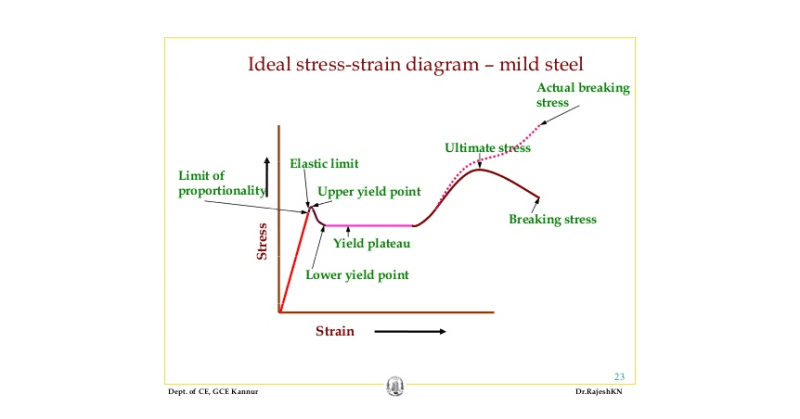

steveh49,
Please point out the elastic yield point and plastic yield plateau in the diagram below, as I have never heard of "plastic yield" before, and would like to know/learn more. Thanks in advance.

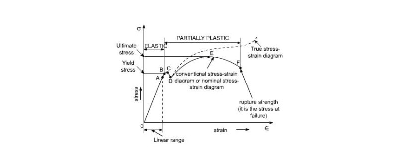

Retired13, in answer to your question on the yield plateau, as a number of people have stated that stress strain curve is not representative of a real stress strain curve for structural steel. One reason is it doesn't contain a defined yield plateau. I think someone mentioned earlier that this plateau is maybe 15 times the yield strain.
This is what I'd expect a real structural steel stress strain curve from testing to actually look like:-

Interesting diagram. I wonder the deformation in that plateau is recoverable or stay permanent.
Yield Plateau

It is transition from the proportional point to the yield point, that can be called non-linear elastic zone, which is located between points A & B on the first stress-strain curve I posted on 21 Jan 20 23:04 (first post down from the OP) I don't think Hooke's Law is applicable after the proportional point.
