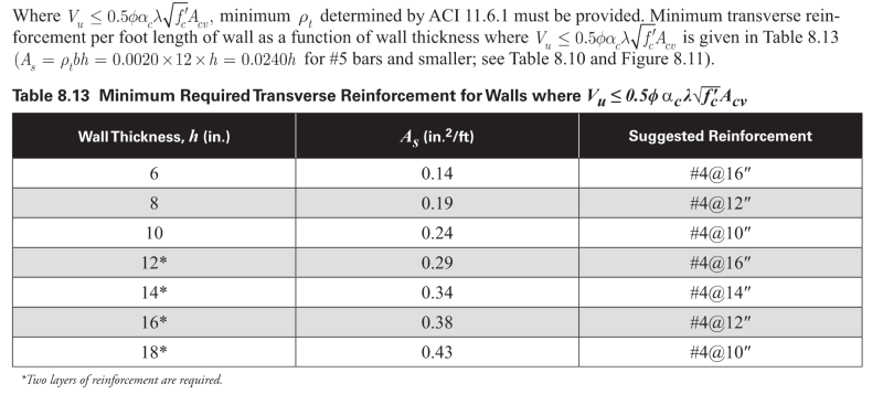

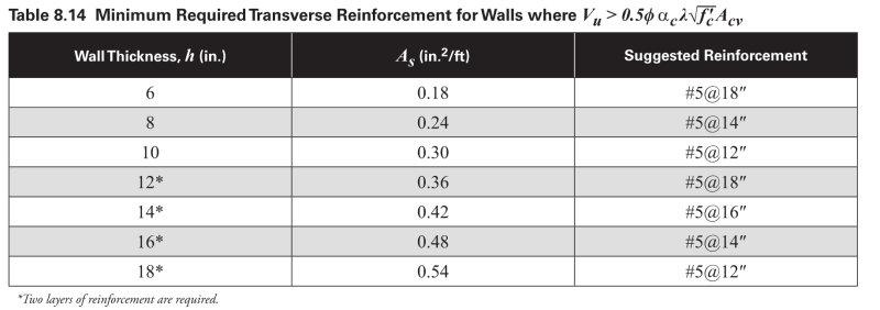

I just found a chart in the CRSI Design Guide for ACI 318-19. Here are some recommended transverse (horizontal) reinforcement for wall thickness:
Both of these charts from the CRSI Design Guide support the evenly distribution of reinforcement between both faces for horizontal reinforcement.
Those charts provide .0020 and .0025Ag reinforcement. Not nearly enough for shrinkage crack control in heavily restrained walls.
