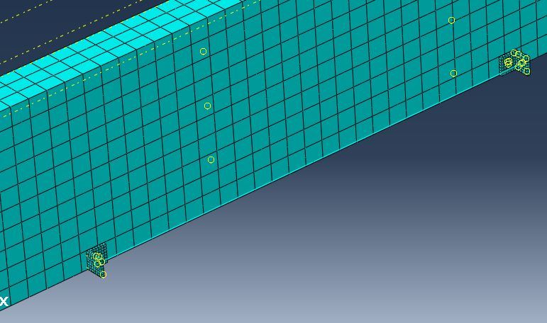

For this model I am simulating a simple long-gauge strain sensor mounted on the side of a beam under uniform tension.
The long-gauge sensor is a wire that is attached to L brackets on each end, which are fixed onto the surface of the beam
I am getting the following error: Too many attempts for this increment (1st increment)

I have a feeling that this all has to do with the way the sensor and the L brackets are attached.
Right now I have the following interactions between my instances:
tie: wire fixed to the L brackets by tying the end node of the wire to the surface of the L bracket
tie: L bracket surface tied to the side surface of the beam.
I have been trying to adjust different things but nothing has worked so far, always the same set of warnings.
Have I missed something very obvious or?
Any advice would be super helpful! Thanks in advance!
