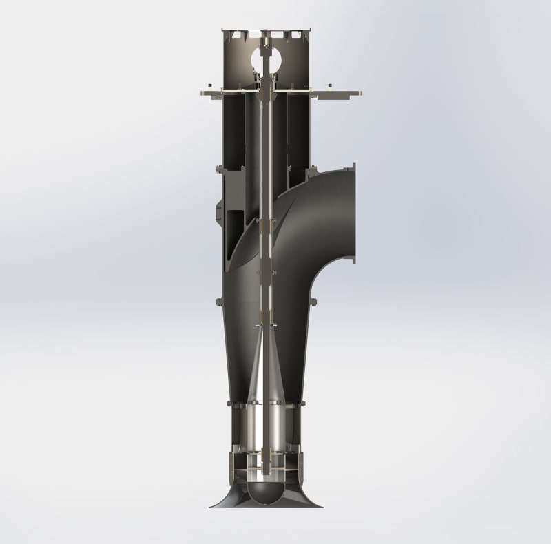

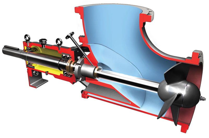

No, not a radial flow pump. In a radial flow pump, the liquid enters at the center of the impeller and is directed out along the impeller blades in a direction at right angles to the pump shaft.
No, not an axial flow pump. Axial flow pumps are of the propeller type, in which the rotation of the impeller forces the water forward axially, and do not strictly qualify as centrifugal pumps. Mixed flow pumps act partly by centrifugal action and partly by propeller action, the blades of the impeller being given some degree of ‘twist’.
No, not a mixed flow pump. A mixed flow pump is a centrifugal pump with a mixed flow impeller.
The submersible pump you are referencing is called a vortex pump.
