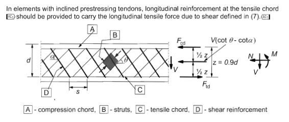

rapt said:
The only design code that explains this fully for all members Eurocode.

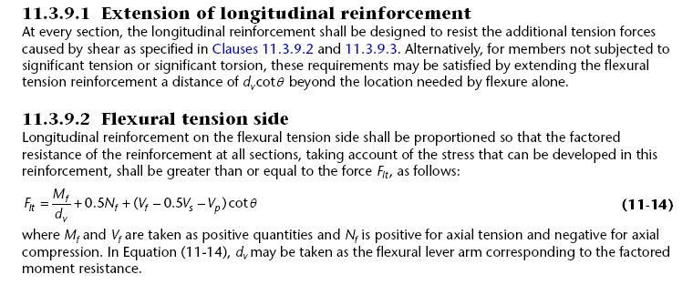

With the eurocode provisions governing this, is there more to it than the sections shown below? The Canadian code has an analogous provision and an associated commentary diagram (also below).

Eurocode
Canadian Code
Kootk
You have shown the EC section for sections requiring shear reinforcement. There is also a section on sections not requiring shear reinforcement and one in 9.2 on detailing. There is also another section in Beam Shear design showing what defined reinforcement can be considered to be active at a cross-section for shear due to the force offset requirements.
The Canadian code is not used widely outside Canada, though the shear provisions are widely read, and Struggle uses either BS or Eurocode as do many around the world.
For PT, the normal procedure is to define where the tendons terminate and then do the design. Yes, it would be possible to extend the tendons to cover the force discrepancy, but then the member would have to be redesigned to account for the change in the PT tendon extents and the force requirements will change. And quite often the tendons stop at a specific location for a reason.
