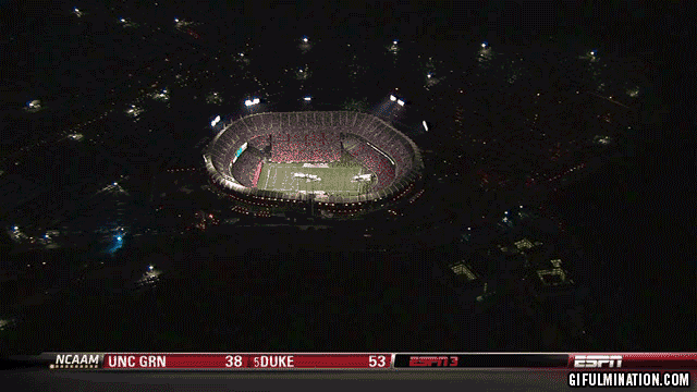

Any electrical emojis? Not really an emoji- but its on my hard drive [wink]
Series arc or the much more common shunt arc? Given the blackout, I'd say it was a shunt arc. Easy to find and clear without taking out more than necessary.
From what I was told about the above GIF was that an overhead splice broke (notice the lights dimming at first due to the delta-grounded wye transformer losing a phase) with the falling conductor striking other phases causing the feeder to trip altogether.
