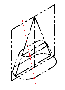

They show a trimetric that matches my interpretation
False. In a trimetric that would match your interpretation of a peripheral shape converging into a single point, the line connecting the two tangency points would end at the apex point where the axis originates:

The least informed place is where you said "Occam's razor, adapted - the simpler geometry is the right one", assuming a shape that would work as you imagine is the simpler one. Try modeling the geometry that you think is the correct interpretation, then model what the standard shows or my version of the shape.

In my opinion they should have included the all around symbol in this case as the intended true profile is made of a flat taper and two conical rounds grouped together. So it does have an oversight, but the principle is clear.

a bisecting plane based on the flat taper and two lines created from the intersection of that plane with the semi-cones. The two lines meet at a point from which an axis that lies on the plane and bisects the angle between the two lines originates.

There is an intersection between the flat faces, nobody said there isn't. It doesn't need to be at the datum point shown. The faces are used to derive the bisecting plane. The point is based on the plane and two conical rounds. The height of the point depends on the length of the shape (between the rounds) and the taper angle.

Example (g) does not show the intersection between the flat faces because it shows the datum, not spoon-feeding every step to obtain it. It is also the example that shows a center plane derived from a flat taper, so looking for it "elsewhere" serves no purpose. Moreover, surely it shouldn't be "contentious" once you've seen all the documentation the standard has on conical tapers providing a datum axis - not much extension is needed for the principle.
