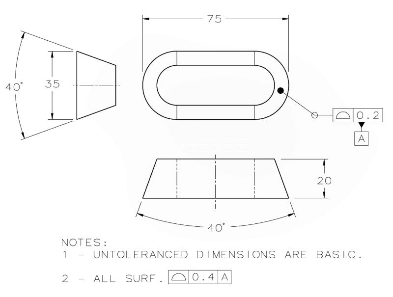

does anyone have idea or references how to profile tolerance a complex trimmed edge on say a vac formed part? I don't really see any good examples in the standard to other places. Would it make sense to just point to the trimmed edge with a 'ALL OVER' profile tolerance with a note below that states "trimmed edge". using "all around" wouldn't work to me as it is controlled only in the view its shown in and a trimmed edge would go all around in 3d.

"the profile defined by" - clearly depends on the definition of profile. Invalid profile = invalid true profile.
It doesn't say - a surface that follows the border of another surface but runs off in some direction.
The surface being controlled has two outlines in each view. Y14.5 surface profile doesn't control based on two outlines.
The Y14.41 faction is trying to expand profile into a universal surface offset, but the Y14.5 group did not adopt that.
Perhaps if you stop defending the bad decisions there would be a little more pressure for better ones to be made.

From your own Y14.5 quotes from the standard which you brought above:
"PROFILE:...,a shape made up of one or more features,..." - there is no requirement for the shape to be fully described by a single 2D outline.
"A model or a drawing view is created to show the true profile" - as I said this this is doable. Even when no model is provided as part of the product definition and one view is not sufficient to fully dimension the surface - there is no restriction from creating additional sections, auxiliary views, etc.

Find an example from Section 11 that does exactly what you claim. All examples are of 2D projected curves, either linear or the silhouette of a surface of revolution, except in the case of "ALL OVER."
The Y14.5 Profile tolerance subcommittee agrees with my interpretation.
Applying the part of the definition supporting "ALL OVER" to any other case is your flawed interpretation.

"Profile of a surface may be applied to parts of any shape, including..."
Which was immediately proceeded with your statement:
"Your case does not meet any of the allowed applications."
How can a feature or a group of features not belong in a category that includes "any shape"? The "allowed applications" you were referring to are clearly just a partial list of what is included.

"Profile of a surface may be applied to parts of any shape," is for "ALL OVER." Note the critical word "part" and not "feature."
applied to parts of any shape, including parts that have a constant cross section as in Figure 11-6, parts that have a surface of revolution as in Figure 11-19, and parts that have a profile tolerance applied all over as in Figure 11-9 (here they mean 11-10).
Obviously, "applied to parts of any shape" is not only for "all over" since "all over" is just the third example out of 3 specific profile application examples provided, and there was no intent to exhaust all possible cases of unique geometries.

Not necessarily. I already told you at least twice how it can be done without a model and therefore without referencing Y14.41.
"parts that have a constant cross section as in Figure 11-6, parts that have a surface of revolution"
Neither of those cases applies to the OP problem. Both are 2D projections as it has been since 1960.
Look at 1994 6.5 and then look at the intentional changes as listed in NONMANDATORY APPENDIX A PRINCIPAL CHANGES AND IMPROVEMENTS. You will not find support for your position.
Unless you have 2D constant cross sections or have a surface of revolution you cannot use profile of surface the way you want.

The OP problem cannot be solved with Y14.5 and sections and views. It requires a note to describe the acceptance criteria or the use of Y14.41.

Appendixes aside, as a fact, ever since the 2009 version, the body of the standard no longer defines profile as "the outline of an object in a given plane (two-dimensional figure)" (Y14.5M-1994, 6.5). And the body of the text has "a tiny bit" more weight than the changes' appendix.
I can correct and complete the figure you dislike from the datums section, without conflict with any current Y14.5 definition or rule:
Profile definition (3.49): "...a shape made up of one or more features..."
- check.
True Profile (3.68): "the profile defined by basic radii, basic angular dimensions, basic coordinate dimensions, basic dimension of size..."

Profile of a Surface (11.2.1.1): "Profile of a surface may be applied to parts of any shape" - no problem.
As I already mentioned, this example is a simplification of the OP's problem that has the same "issue" which he was concerned about - a peripheral surface surrounding the part which is not normal to the plane of the view projection or any other plane. Nothing to be worried about. Solvable with the all around symbol, and some additional views for full dimensioning and a lot of effort if a model is not provided (unlikely).
The error was made in 2009 to add "ALL OVER." There is no support for the change as a purposeful one as they fumbled the definition to do so. They added no example besides for "ALL OVER" indicating no intent and specifically did not add such descriptions as they did for profile of line.

You can guess all you want about what the intent was, the definition is what it is, and it supports that all possible types of geometries can be profile-controlled.
Why would I care that it "does not resolve to a point"? It matches the so-called "Complex" ("type g") feature category shown in the 7-3 table, and even if the specific proportions I made up do not allow the extrapolation of the surface to converge into a single point, that feature can still be used to constrain 6 degrees of freedom and establish 3 orthogonal planes and a reference origin for tolerance zones. It can be done in multiple ways too. The fact that you are looking for some specific datum point as the key to a solution only underlines your poor understanding of this subject and indicates that your experience doesn't go much beyond simple textbook / Y14.5 standard / training material examples. Good luck with learning.
You should care because that is what the diagram for what it controls shows. As I indicated, you don't even understand the error and made up an unrelated example that is not supported by the Profile subcommittee and the work they produced for their section.

As I already showed - the profile section has nothing against applying profile to any shape of a surface or surfaces.
There are an infinite number of things the standard does not deny but those are imaginary.
It is intended to show what is allowed.
Your other source matters not at all - the figure in the standard is incorrect and your fix makes a worse stab at it. There are infinite possible figures but the case is the shape shown does not match the constraints shown.
"It is intended to show what is allowed"
That is correct, but contrary to what you've been arguing, it doesn't mean that what is not shown is disallowed. In the context of the figures in the profile section:
